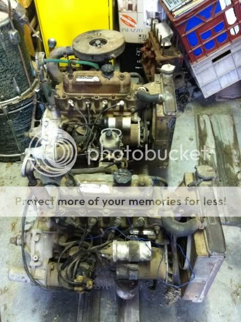

Bought these two 1275's today, one thin flange small journal crank /s rods, one thick flange large jnl / chunky rods. Untouched since bmc electronically tested them. Stored for 25 years by a farmer who at one stage had about 20 morris 1100s and 3 minis.
A few questions: diff ratio for 1100 S? 4.1?
What are the gear ratios like?
Can you fit the 1100 rad in a mini? It looks slightly longer?

Hmmn sadly thats a 3 synch box, what are the engine codes?
12YA TaH?

Just looked on the 1100 website. 12yd h xxxx Both have the same prefix.
So 1275, manual remote 4.1 diff standard ratio, high comp.
What was the "high compression" 9.75 to 1?
Diff would be good for hillclimbs!
How does the gbox no tell us it's 3 synchro?

All the Morris 1100S came with the 3 syncro box.
The "D" in the engine number shows the 4.1 diff.
The "H" compression ratio is 8.6:1

Thanks, so can the Gbox case be used for 4 synchro gearset?
Also will the small journal crank fit straight in the block with the large jnl crank? Do you you have to muck around with adjusting thrust washer clearances?

Cranks swap easy, no funny thrust washers needed.
Sorry, no can fit 4 synchro gearset into 3 synchro box. Find a 4 synchro remote one... Mini K, early Clubby, Mk2 S.

I have an 1100S engoing and gearbox in MS Plum - all dropped straight in including the radiator.
Have recently changed the diff ratio to a 3.1 as the 1100S diff whilst very quick off the mark maxed out at about 90kph
