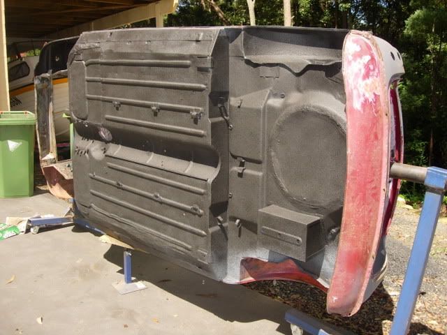

This is (was) mine. Can't tell you how long the legs are because Josh has it. :twisted: From Memory maybe 1000 mm high?It has to be more than 1/2 the width as when it turns the distance from the centre to the corners is more (does that make sense?)
Dave K.

Thanks Dave, It's still at the panel beaters as we all know how long they can take, if you need it back i'm happy to take the car off and return, just ask :)
