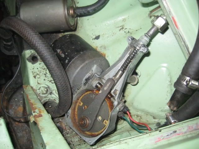

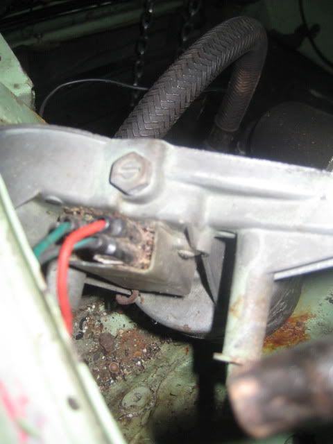

If your loom has four wires to the wiper motor it's a pretty good sign that the car had two-speed wipers at some stage. Confirm the wire colours from information in the following thread. Two-speed wiper motors and the proper switch are readily available should you want to reinstate this feature.
http://www.ausmini.com/forums/viewtopic.php?t=49056

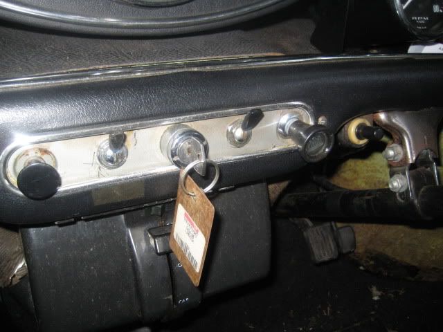

Separately, here are a couple of pictures of my wiper motor. While there is space for a fourth terminal, I don't think there is one. Can you tell at a glance whether this is a single speed wiper motor? I do note that the nut holding the wiper motor switch in the dash is different than the one holding the headlight switch--unless they were originally different, I'm guessing the wiper motor and switch were changed out (recalling that the fourth wire is present at the motor)? Photo attached for this also.
From that same photo, the clutch knob/cable on the car is the plain black knob with a "C" on it. Per the Mini Experience article on the '69 S, that knob should be the one that looks sort of like a four blade fan. Was there anything unusual about the police S in this regard? The one on there seems far too long, and I have the replacement pictured in TME which seems the right length?
Thanks and talk soon,
Ben McCafferty
Wiper motor with front plate removed:
Wiring, end view:
Dash switches (currently headlights on the right, wipers on the left):

PostPosted: Fri Feb 18, 2011 9:30 am
Posts: 2276
It could be worth trying to determine if the whole switch panel
Itself is correct for your car.
There were lots of variations in the switch positions over the life of the aus produced minis.
Have a careful read of my old post here.
http://www.ausmini.com/forums/viewtopic.php?t=59942&highlight=wiper+switch&sid=dc30e7d4b4c985f804aeec4aa01a7ed8

PostPosted: Fri Feb 18, 2011 10:09 am
Posts: 285
Hi again phillb,
I read your old thread on switch positions. It seems that most of the thread pertains to mk1 cars, yes? However, there was one entry in particular that seemed relevant:

I don't now how to define "early" vs. "later", but if this previous thread is about mk1, it seems that mk2 would qualify as "later"--would you agree? In my case, I have the following (left to right): choke, headlights, ignition, wipers, heater (washer below and to the right). Both switches turn "on" when flipped downwards. Based on TME (vol. 14, page 59), it would seem that everything I have is correct, except the wiper switch and motor because the car is ex-police and has a fourth wire taped back out of the way at the wiper motor. However, the wiper motor has a mfg date of 6/70, and the car has a build date of 7/70. Not sure how fast Lucas Australia got parts to the factory, but a month seems reasonable and makes me wonder if the single speed wiper motor is possibly another example of a changeover period from previous SPO's to SPO.41, i.e. similar to my car having 1 1/4" carbs instead of 1 1/2"--my thought being that the wiring might have been in place but the two-speed motors not yet in use? I'll have to go back and read Watto's article, I don't recall whether earlier SPO's called for 2-speed or not. If they did, I would conclude that the motor and switch are wrong and have been exchanged at some point.
Thanks and talk soon.
Ben
Ben McCafferty
1970 ex-police mk2 Cooper S
PostPosted: Fri Feb 18, 2011 12:53 pm
Posts: 2276
There is a definate known changeover during mk1 production where the wiper motor changed to a round one and the wipers swapped to sweep the other way and it seems at that time they swapped the position and type of switch.
Im not familiar enough with mark 2 to know if they swapped the positions back again. They did swap the choke and heater positions didn't they?
If yours goes choke/wiper/ign/lights/heater(L to R)
....then it is the total opposite to mine. Maybe that's correct for mk2?
What does you handbook say? (although they have errors also)
Main reason I posted was that I discovered the panels the switches are in also vary. So if someone has replaced the panel that could confuse matters as it sometimes forces the switches into certain positions. Just wanted to make you aware of that.
There should also be dates on the wiper light and ign switches and as you say a month or 3 is the usual variance in the dates I think. Although not that unusual for switchs to die over a 40 year period.
