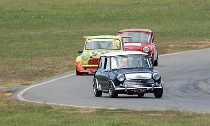

I was running my Grp Nb Cooper S in the Regularity events as I have a CAMS National Rally licence rather than a circuit equivilent, but for interest's sake the car's fastest lap was a 1:16.2 which would have placed it mid-fieldish in the Grp N races.
The car runs a BMC 3-syncro, 4-speed, straight cut, close ratio gearbox. Standard Cooper S primary, idler and input shaft gears, A 3.7 final drive and Quaife LSD.
No idea of speed, but 4th gear was picked up about 50 metres before the start/finish line after holding third to 7500rpm. I would guess that it was pulling somewhere between 6500 & 6800 in 4th before braking and going back to third for Turn 1.
The 3.7 seemed pretty well suited to the track.
Thanks for the photo Shane.
Curly
