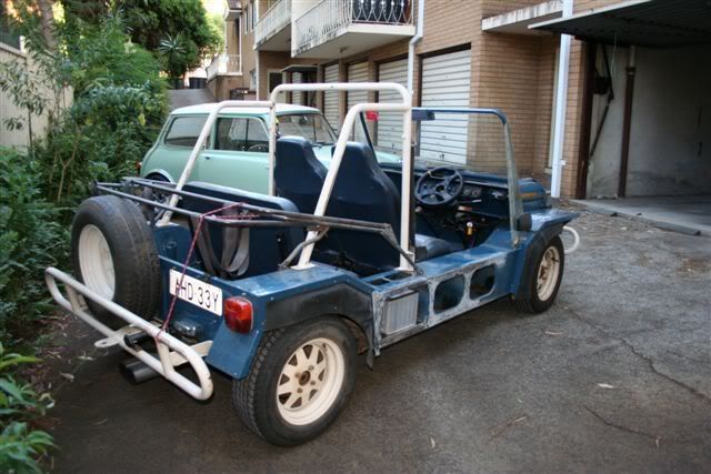

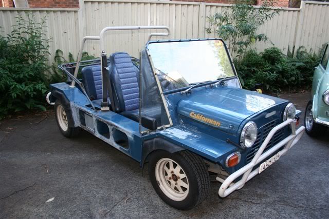

Hey guys... I thought i would ask here before taking my car to a shop somewhere...

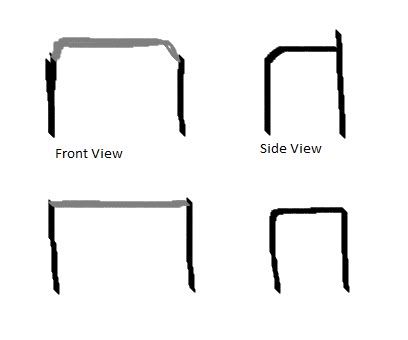

I have just purchased a hard top roof for my moke (no comments please... i wanted one and although its not everyone's cup of tea, its what i wanted....) however because of the centre piece of the roll bar, it will not fit. It will fit if the middle bar is cut and replaced at the top most part of the side bars... refer my super quick pictorial explanation and pics...
Pic of Moke Bar from back
Pic of Moke Bar from front
Is there anyone on here in Sydney that can do this for me for a few bucks on the side? It doesnt have to be pretty, just solid.
That aside, does anyone think this will destroy the structural integrity of the roll bar??

Any thing that is designed to support weight should never be cut and welded, "Moke upside down" it loses its integrity, :shock:
but the correct way to do it, would be to cut off the 2 top braces coming in from the rear and then remove the required length off the bottom of the uprights and then weld the top back in position, that would be the strongest and safest way to go about it.
8) 8)
But, if you don't care about losing your head, weld a piece across where you want it and then cut off the excess with a grinder. :roll: :roll:
My 10c worth, but I feel that there will be more suggestions to come :wink:

If you're going to get an engineering workshop to do the work, get another hoop bent to replace the higher one. Doing it your self, you could detach the hoop and lower it by cutting down the legs then re attach (or get a new hoop to size) use a tube in tube strengthening if you're going to cut mid length.
Consider:
Seat Belts loading and compliance will be affected if you cut and shut.
Your head may get into striking distance if you lower the hoop. Roll bar always wins in that type of collision padding or no padding.
Consider a seat replacement that has integrated belts (BMW850i for example) and run with swappable cage or hard top

They are nothing fancy in terms of steel grade or design, in fact they were made from HD Exhaust Pipe. Same too as the front & rear 'Californian Bars'. Also, as far as being a roll bar, they lack a diagonal brace, so how effective would it be? Now I know this sounds negitive, but I will also say that all things considered, they do work well and better than none at all.
Now, back to the problem at hand. Yes I would be happy to cut and shut it, however, I would insert an inner sleave (another tube inside the existing) at any joints and make these at least 300 mm long. It might mean removing the top mount for the seat belt, fitting the tube, welding and then refitting the mount. Also, retain the original bends, don't try to mitre joint it. Lastly, be sure that who ever does the welding is a qualified welder. Maybe the Doc could help out here?

Well the roll cage got removed last night in preparation for this weekends epic adventure. I cant believe that the cage is held onto 2mm body metal with NO backing plates with screws 4cm long and less than 1cm thick!!! (not sure if this is like this on all mokes or just mine)
It turns out that the join for the top bar on the passenger side had cracked 3/4 of the way around and the only thing stopping the thing cracking all the way was the pressure of the back mount pushing forward.
so....... looks like its off to Bond Roll Bars to get something fabricated in the not too distant future.... :wink:
