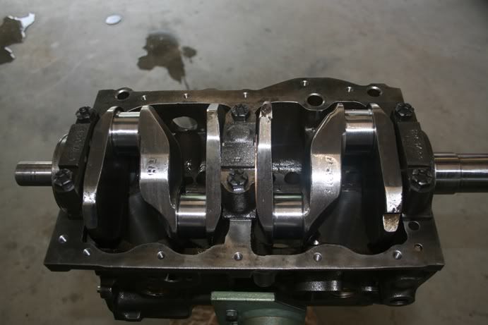

I have a 1275LS crank and after some advise I then aquired a set of A+ rods which do not have the big counter weights of the original 1275LS rods.
The crank has now been wedged and balanced.
One day it will be assembled and have a Supercharger assisting it to spin. :wink:
