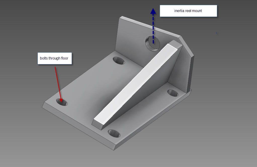

PostPosted: Wed Mar 23, 2011 12:32 pm
Posts: 10654
This is what I'm thinking: A matching plate under the car would be fitted to stop it ripping through the floor.
(illustrated is for the passengers side, its a funny shape because the floor isn't level in the bottom of the bin)
PostPosted: Wed Mar 23, 2011 4:20 pm
Posts: 3635
Location: Gulgong
Are we talking about the Clubby type inertia reel seat belts here ????
This has been discussed a few times in the past if it is those. The major problem is that the B pillar has been substantially updated in the later models to support the strain of the extra mounting point which effectively acts as a snatch strap.
It increases the mechanical efficiency of the seat belt to the point that its likely to pull the B piller inwards in a reasonable accident.
People say that if you are in that sort of accident then the cars deformation is going to be significant anyway but the extra mounting point does substantially increase the load on the pillar and its a load it was not designed to take in the earlier minis.
Mike
