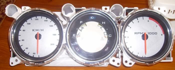

It's not hard to make your own. I'm still in ideas mode atm and this is 1 of them. I was also thinking of getting them printed on vinyl.
Click on the pic for the full size. It does print at the actual size for the guages though.
All I did was scanned the face plates and went nuts in photoshop. I havent gotten around to the speed part yet. but it will be themed accordingly. The black holes and rectangle represent where the needle, faceplate screws and odometer are located.
