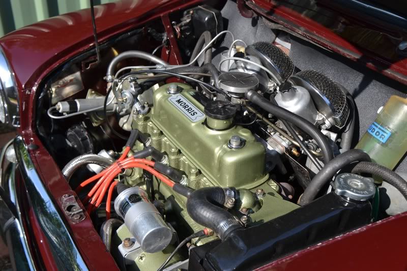

Is anyone able to post picks of where to mount a booster, i need to give them to my mechanic so we can orgainse the best position to place it. i have a '78 clubby
i am going to have it on the drivers side ifrint of the master but need orientation and height?
thanks guys
