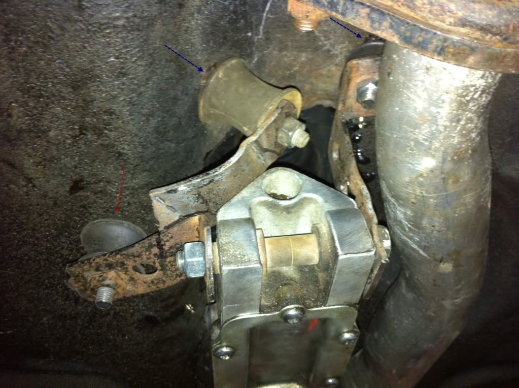

I don't have a photo at hand of my finished remote to rod conversion, just this early layout but the finished one wasnt much different:
My setup uses three rubber cotton reels (normally there's only two). Two of them are mounted to the existing tunnel holes (blue arrows), and only one hole was added for the third stabiliser. No other modifications were made to the transmission tunnel.
The finished result is very strong and stable, compact and easy to fit.

I think harley has it licked.
Remove the shifter lever and then fit it up to the gearbox by the steady bolt. Then you can lift it to the floor to mark out the mounting holes.

The photo from Harley looks like he may have lost some ground clearance. Hard to tell, and may not be an issue.
PostPosted: Fri Apr 01, 2011 3:10 pm
Still 100mm from the ground, and not the lowest part under my car, it's virtually level with the exhaust system. No offroad action for me though.
