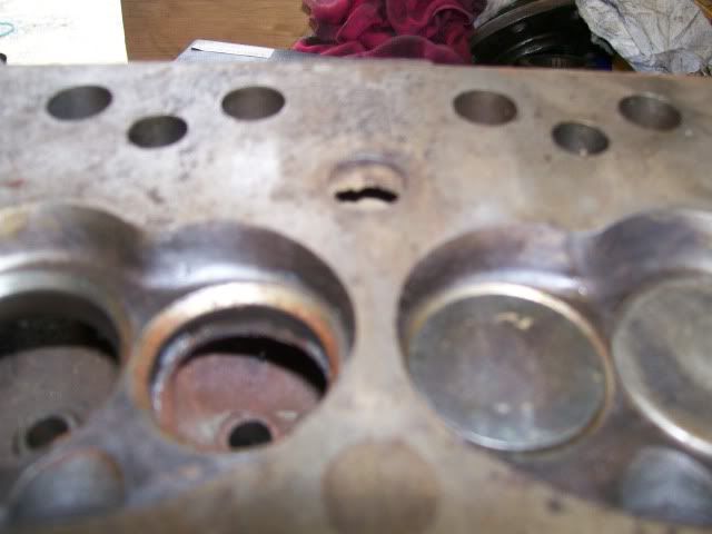

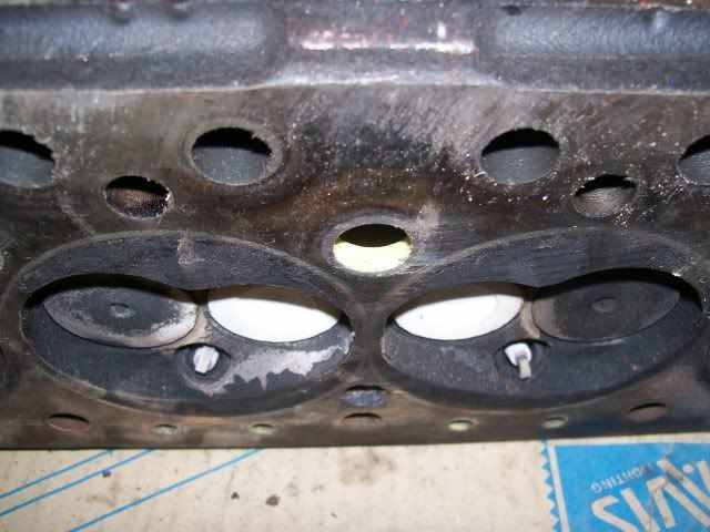

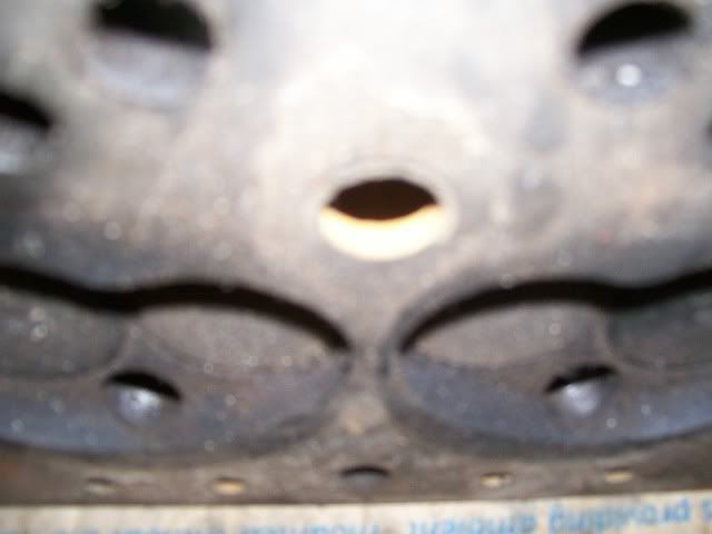

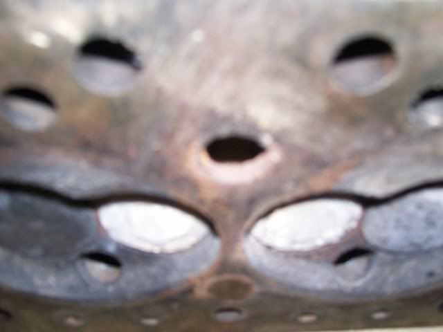

Yeah I was just reading this... I was asking the doc what he knew about it (because I couldn't be assed diggin out alll the heads). What I found when I measured them (inc a few different post '83 heads) was that at least with the heads I had at hand, there was no serious difference.
I must point out,,, these were not new heads.
These are some of the heads.
Metro MG
Late model injected head
MK II Cooper S head
Sorry, this one is a bit crappy... but its an MG metro turbo head
And you know what? :D After digging all the heads out, and taking all the photos.... I just realised, that photographed THE WRONG BLOODY HOLES :oops: :? :lol:
