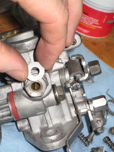

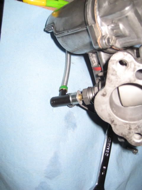

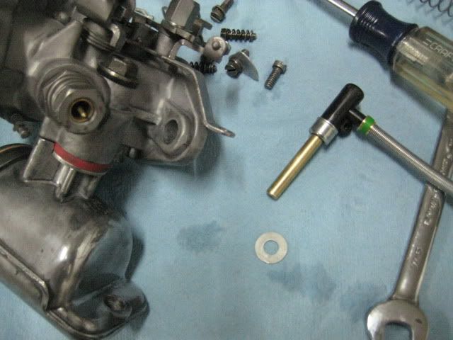

Buffed out the first carb yesterday and reassembled. I had one part left over, a small, flat aluminum washer. Looking at the other carb today, I think this washer goes on the needle jet, i.e. the jet that slides up and down and is attached to the fuel line from the bowl.
(By the way, is that sliding jet the choke?)
Three photos below--to show where/how I think it gets installed. Can someone verify that this is correct?
Posting some pictures on my other thread also of the buffing of the carbs--they came out really shiny and nice. (members mini gallery-- http://www.ausmini.com/forums/viewtopic ... 974#802974 )

Correct Ben,
Dave

PostPosted: Wed Apr 06, 2011 10:30 am
That flat washer doesn`t really need to be there, it was (more than likely) left over from the "fuel-Miser" brand of jet that was probably previously fitted to the carb
the new jet you are showing in the pick is the correct SU item (p/n TK6000) & doesn`t generally use that flat washer
however, it won`t hurt it being there, just not needed
The old jets are black plastic on both ends, with a black rubber hose in the middle.
The only downside I can see of having the washer on the SU is that it would limit how far in I can adjust the big nut that the jet rides against. But I have a feeling I don't need to adjust in that far anyway.

The MiniMan is correct (as usual). :)
The Fuel Miser non-genuine jets were (are?) slightly tapered where the plastic jet body sat against the adjuster nut. Sometimes the plastic jets would actually stick in the adjuster nut. Fuel-Miser's quick-fix solution was to include that washer in the kit. :roll:
