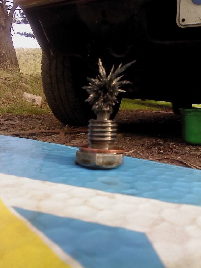

I was driving to uni the other day, when I noticed that the gearbox was noisier than usual. I drove there and back (about 45km each way), and by the time I was back home the noise was quite noticeable. There was always a bit of a whine when slowing down, but it sounds a lot more 'crunchy' now. It only makes noise in gear and when moving at speed (no noise in neutral or with the clutch in.
Anyway, I figured the first thing was to change the oil to see if there were many metal pieces in there. I changed the filter while I was at it. The old oil had only been in for about 2000km (I normally change every 3000).
Anyway, this is what the magnetic pickup looked like:
There's a lot more there than usual. Anyone know what would be causing it? I'm guessing it may be the layshaft bearings or something similar, since it only happens when in gear, but I don't know much about gearboxes. Changing the oil improved the noise, but it's still there.
Would it be safe to drive it the 50km to the mini mechanic?
PostPosted: Sat Apr 16, 2011 5:47 pm
I wouldn't even be putting the oil back in.
You could guess any component as the problem here, but the best advice is to get that engine and gearbox opened up.
I wouldn't drive it another meter if you are hoping to get an extra mile out of the engine. Another 50 miles and you might as well add the cost of an engine on top of the gearbox bill.
The condition of the engine is dicey enough as is however...

With fresh oil and new oil filter I would suggest it should be OK to drive carefully to a mini mechanic.
Only major issue is if you have too much worn metal bits floating in the oil then this could work it's way into the engine bearings, but for 50km and careful driving you should hopefully be ok. Maybe phone your mini mechanic before driving to him
Problem could be anything but your suggestion may only be part of the issue
I would do a complete overhaul with all new bearings

drop gear bearings, more specifically the idler gear bearings

I think I'll drive it in to the mini specialist anyway. I'm just afraid of it breaking down before I get there. It might just be easiest to swap the whole power unit - it's only a standard 998, and people seem to be just throwing them away. The gearbox was never great, but the engine pulled great for an unmodified 998.
If the mechanic says it's repairable (i.e it hasn't ruined the engine, just the gearbox), I might have a crack at rebuilding the gearbox myself.

to see that amount of crap on the end of the sump plug used to be a regular occurrence with my old motors I had many years ago. :lol: They all still ran, for ages, but eventually will die like anything. Drive it casually to the mechanic, and you'll be fine.

With all these pictures of magnetic sump plugs, I was wondering if anyone uses the long ones that Minispares offer?
Are there any benefits?
HRS
PostPosted: Sun Apr 17, 2011 2:16 pm
The idea of the longer one is for use with a centre oil pick-up.
You stick the magnet where the metal is being drawn to.
