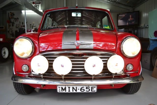

I used 2 x twin relay NLR-132 fused for 30A. One relay does main and high beam (H4 conversion) while the other does the four (100 watt each) driving lights.

Dave's photo above looks just like new era's reincarnated.
