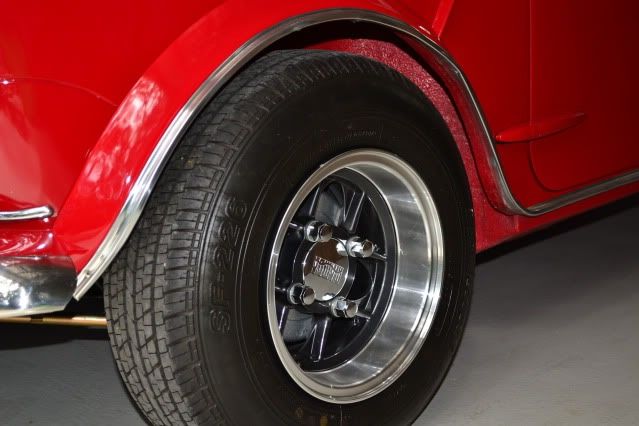

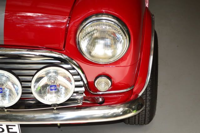

Jim,
These are ET-7 on a standard drum brake front end. Just about right with the MK2 Cooper flares.
This is a good calculator to give you an idea of how it effects how far the wheel sticks out:
http://www.1010tires.com/wheeloffsetcalculator.asp
Dave K.

Just typed a few figures into the calculator.
If you went a 6" rim with ET+7 the wheel would come in 26mm which may foul on something but only stick out a further 12mm.
ET-7 would come in 12mm and extend out 26mm.
Dave K.

Non spacer drums?
PostPosted: Sun Apr 24, 2011 8:40 am
Posts: 903
Location: Hunter Valley, NSW
^^^^^^^ Yes - non spacer - just the normal flat ones. Did have spacer drums on the rear but have replaced those with flat ones as well. Only mod was having to replace the rear wheel studs with shorter ones.
