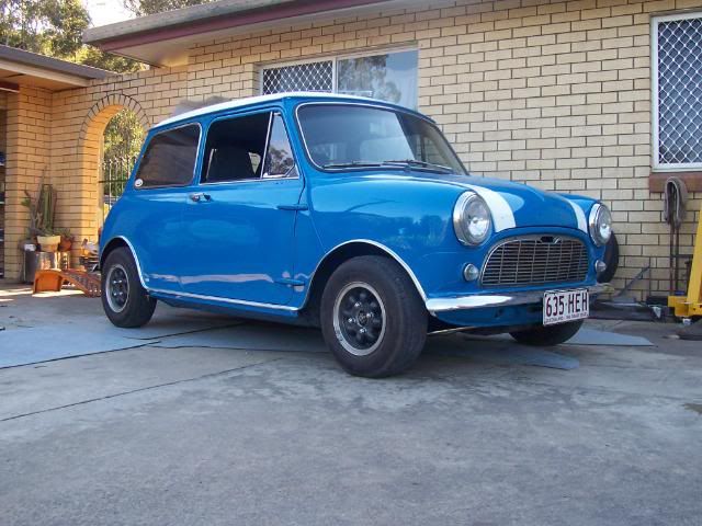

This is what I run in Lillee. See signature pic.
LS Contessas are very popular on the Group N cars. It makes them hard to get.
Dam straight! I haven't seen a set for sale for yonks, like last 4 years. Luckily I have a spare set stashed away...
