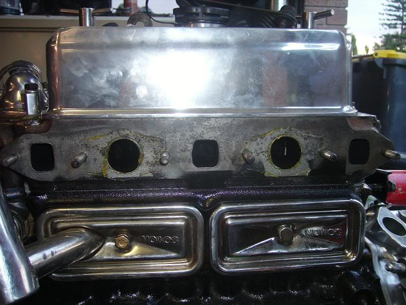

PostPosted: Sun May 01, 2011 7:19 pm
I did something simlar but I used Grease. As I had new Inlet manifold and LCB I want to know how they matched up. Smeared the grease on (in this pic) of the Inlet manifold and clamped it on.
Yes the manifold can have a little bit taken off it so the ports match
But myself to put a engine in I do not have Exhaust or Inlet manifolds and no Radiator or Alternator...I like as much room as I can swing the engine around
