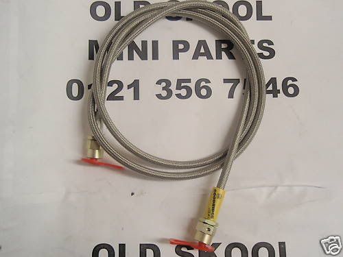

I was priming the engine yesturday just turing it over with out the plugs in just to get the oil circulating threw the engine...and noticed the oil pressure hose was leaking.
its not a cheap one...think it was $50 from uk
Ive done it up tight but its still not sealing on each end.
the one im using is this kind.
I was thinking it may be becaause the threaded bolts diddnt come with this hose even though they fit ?
as it had a crapy plastic type last time.
the bolts in question are the ones on the end the one that goes into the block and the one that goes on the gauge.
might have to upgrade to an autometre item seeing as im using all autometer gauges anyway?

With my cheapie plastic oil hose it has a small fibre sealing washer that fits inside the nut and seals against the guage and the engine block adaptor.
Maybe your missing this?
Other option may be to use some plumbers tape?

well i found out the problem..
the hose dosent suit the little nut adapters ..
the one on the block wich is a standard bmc item and the one on the gauge are not tapered....so it wont seal...
bugger ...might have to install another hose kit ...cheap one for now untill I can sort it out the right way...might have to pay enzed a visit...

The standard fitting onto the gauge itself has a tiny flat seal in it. If it ain't there, it won't seal.. :wink:
Description- gauge washer, pipe to gauge.
p/no is GUG705647GM
