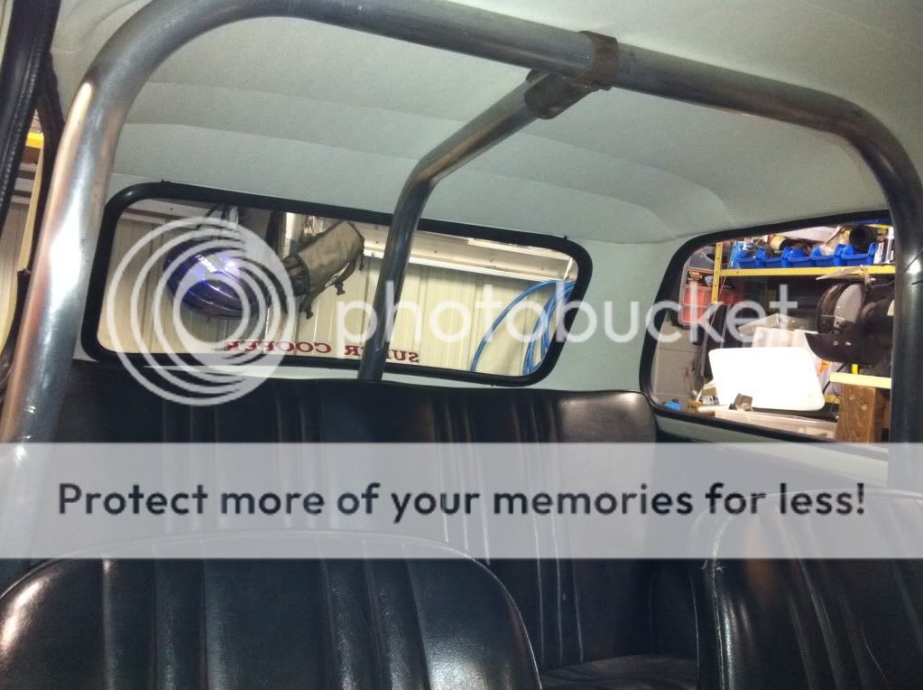

PostPosted: Wed Jun 08, 2011 11:17 pm
Posts: 658
Location: NSW
I just had a Newton Headlining fitted. Looks great.
I did order a late UK model kit and the Cpost liners where too big, so I emailed them to buy new Cpost liners to fit my car and they said they would send me a new complete kit for an Aust. car for nics!
They didn't want the old one back either!
Only pic I can find:
Now with 2 extra ports!
