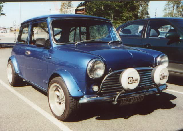

we did ours with thinner perspex ,,, er ,,, ar,,, um,,, glass,, i mean glass ;-)
probly have to look close to see the windows, sorry it`s the best pic i have of the thing
