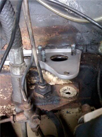

Mine looks a little different to 850man's (I wish it was as clean too). I've sandblasted the top bracket to get rid of the rust, I'm painting the bracket and sticking it back on tomorrow. I should probably clean up the engine bay and the hole for the pedal/pins/actuators. Hope the photo's help. I can take more if you want as long as I get your message before I reassemble.

yours is a little different and yet exactly the same, if you look closely, the bracket that holds the hydro and brake pipe tee is a separate piece held on by the clutch hose. The bit fixed to the body is the same as what 850man shows.

As you can see in the pic above from Wantone, there are two brackets, one that slips on the master cylinder bolts (i have this one) and one that is spot welded to the firewall, i need this one.

I think you just need to get creative. If it were me I'd bolt the top bracket in and then position the engine steady, this will show you exactly where the lower bracket needs to be.
The dimensions should be a mirror image of the top bracket.
Then you need to do the same for the brake line side. Just position the brake line and all its components where they look "normally" and make the bracket to the right size to support everything.
I just went and gave one a quick measure;
The bit that sticks out in 70mm wide and 40mm out.
The base plate is 120mm wide and 30mm high.
Just had a look at your pic and the base plate is still their so if you run a tape over that it will help explain my measurements.
And if you look at the previous pictures you can see how it's meant to be shaped with the brake and hydro bracket being a separate bracket (you should be able to get this of someone easily or just make your own).
