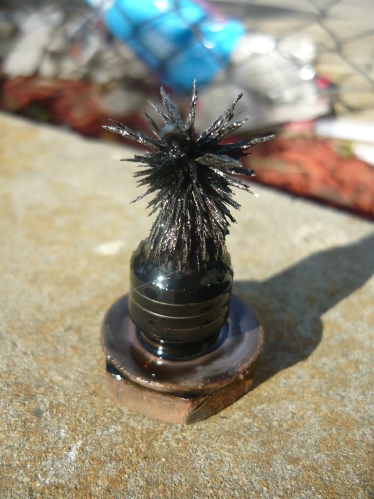

Pulled this out today to change in a thicker oil.
Not expecting it to last too much longer, just long enough for my replacement car to be ready lol

Has the motor had regular changes in the past or is all the metal a new occurrence?
I have seen motors with this much metal in one oil change that have lasted years with regular changes.

actually now that i think about it ive not pulled the plug on this car before...... ive just always been filling it up. Was using a fair bit before but sinse hay its been using up to a litre of oil a week, mostly burning.
'63 850/1100 + more cooper goodies
PostPosted: Sat Jul 16, 2011 8:07 pm
Try changing the oil again at 1500 miles or 2500 km and see what it is like.

Anyway, i say always inspect closely what you find, if it's fine particles then carry on, if it's chunky like my last oil change where i found bits of diff you have a problem.

arh that's normal Calin.. that's to be expected from a mini that hasan't been changed in a while... :lol:
Wait till you pull out bits of diff, and gears as others say :lol:

bah that oils still good.... look at it sparkle.
