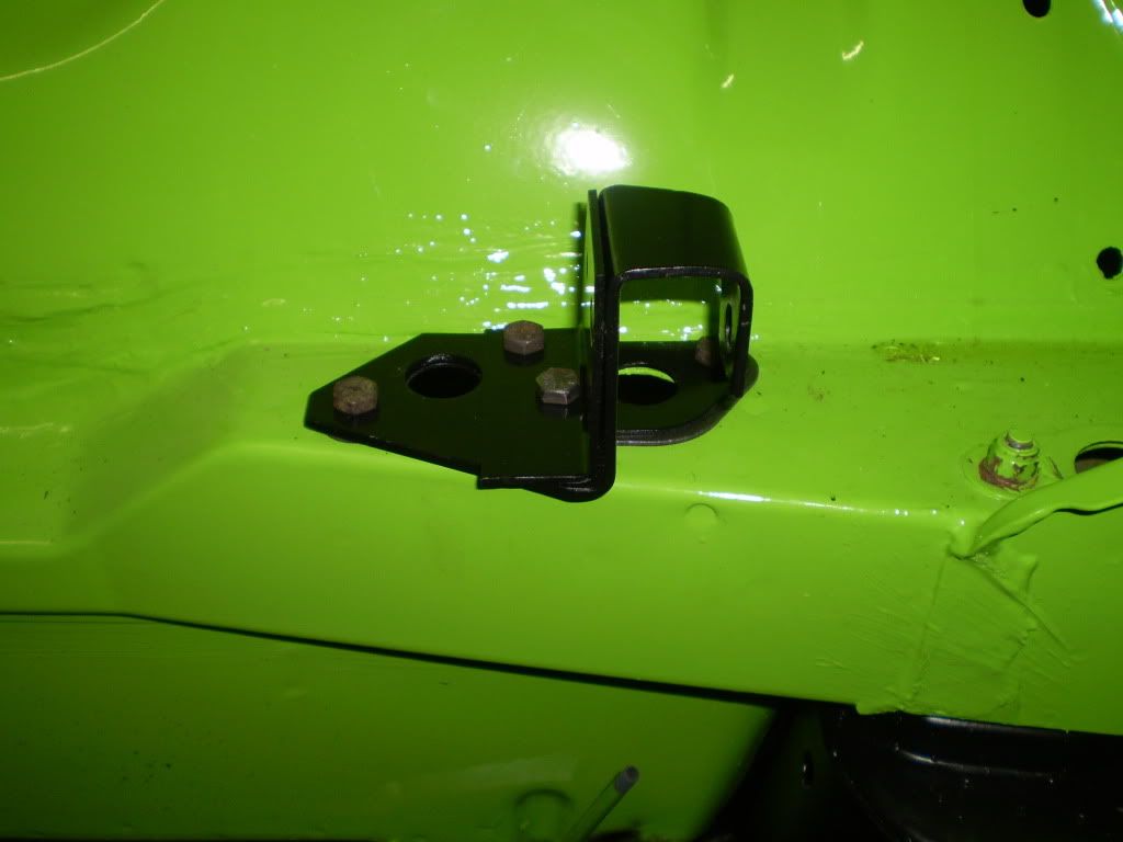

So I think I may have figured out at least part of it. There's an engine steady under the clutch master cylinder right? And the opposite side of the bulkhead has heater hoses or something running through it?
Am I on the right track?
Where do the other funny angled brackets go, ther'es an L-shaped one and an L-shaped one with an upside down U (Have I confused anyone else yet)? I'm guessing these go on the opposite side to the master cylinders for an engine steady.

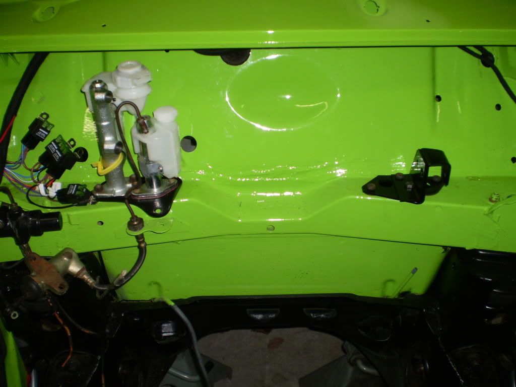

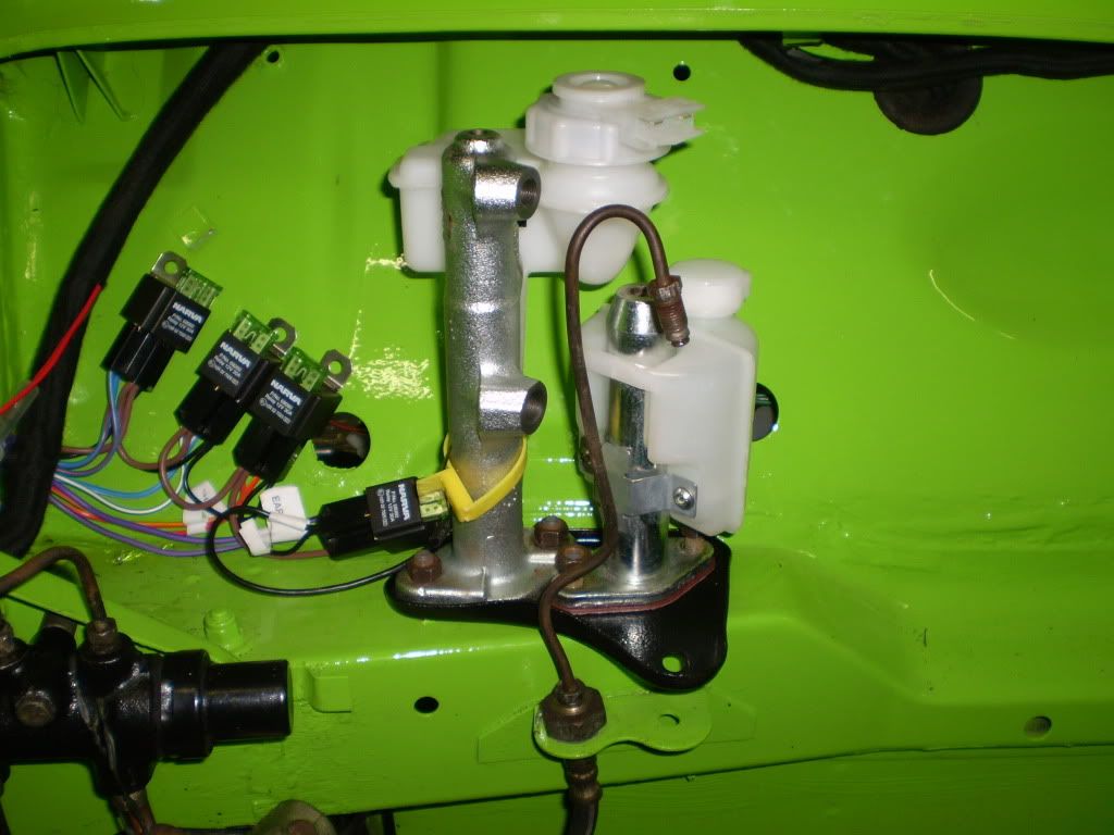

Does this look right?
Cheers, Matt
Don't be fooled, Gruhms is not my real name.
PostPosted: Thu Jul 21, 2011 5:48 pm
Joined: Mon Feb 21, 2011 7:13 am
Posts: 433
Location: Blue Mountains, NSW
I found an old picture of my engine bay when it looked like the BFG had taken a dump in there. I think the setup I showed in the last post looks right. I'd still be more than happy for people who know more than me to confirm it though.
Thanks.

Yeah, that looks right.

Just wondering if you put a gasket under the base plate . I'm not sure that they supposed to have one , but wouldn't water be able to find it's way in there without some type of sealant there?
PostPosted: Thu Jul 21, 2011 6:54 pm
Posts: 433
I did wonder this myself.
I've got a gasket under the plate on the passengers side, and I've got gaskets for the master cylinders on top of the plate. I do have a gasket that could go under the plate for the masters, but the hole is too small for the brake master to go through. I suppose I could just enlarge it.
Cheers, Matt
PostPosted: Thu Jul 21, 2011 6:58 pm
Mine has a gasket between body and steady bracket: its not normal gasket paper / card but more of a waterproof sponge material that compresses more.

Yeah, that's the stuff I've got. I've got proper gaskets for the cylinders and then the spongy sort to go under the plates.
