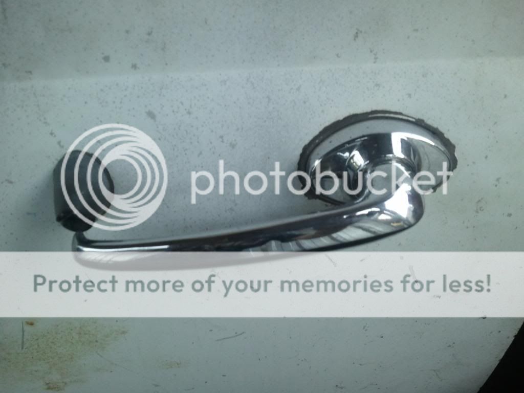

yep sorry, no other way of asking for it... anyone who owns a roundie with the doors that have these handles (that I hate mind you :lol:), can you tell me are the chrome handles themselves able to be swapped from left to right hand doors?
Reason I ask is I have a RHS door for sale with a broken one of these, however this is a picture of a LHS door that is buggered that the handle is perfect, so was hoping since its just the handle that's snapped off, will they change over?
Also how the heck do they come out? how can you get to the screws behind/ inside there? The door is guttered, but still it looks a PITA.... :shock: bloody roundies :lol:
PostPosted: Mon Jul 25, 2011 11:49 pm
My car has two passengers side handles, because I didn't want a visable external lock.
So yep, it'll fit. Once the glass is out of the door, remove the square pin on the inside lock, and the circlip on the handle, remove the plate between them then poke a screwdriver in and undo the 3 screws holding the base on.
