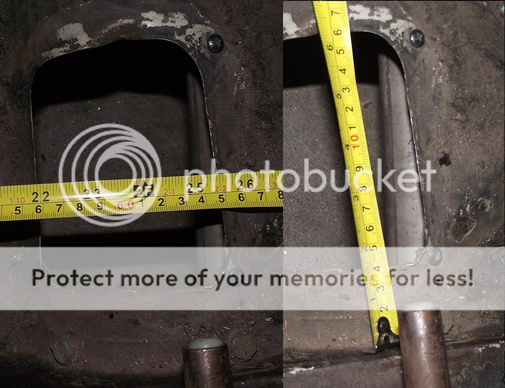

Can anyone measure their floor for me, to tell me exactly where the hole is positioned for the gearstick as I need to cut it into my floor.
I am changing mine from magic wand to Remote.

I would also like to know this, Mine needs redoing as the PO has cut out about a foot square.

my car 1969 morris
measured from the inside of the door sill
