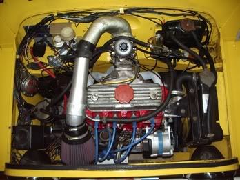

I reckon cold air is a waste of time as Morris said. If you have read Visard and want a long intake for mid-range torque you could try something like mine. It is a bit backyard but it works suprsingly well and was a million times better than the pancake K&N that I had on there and about 100x better than the stock donut. If I was making it again it would be a slightly smaller diameter and maybe not povo plumbing pipe and an asparagus can coverend in fibreglass :lol:

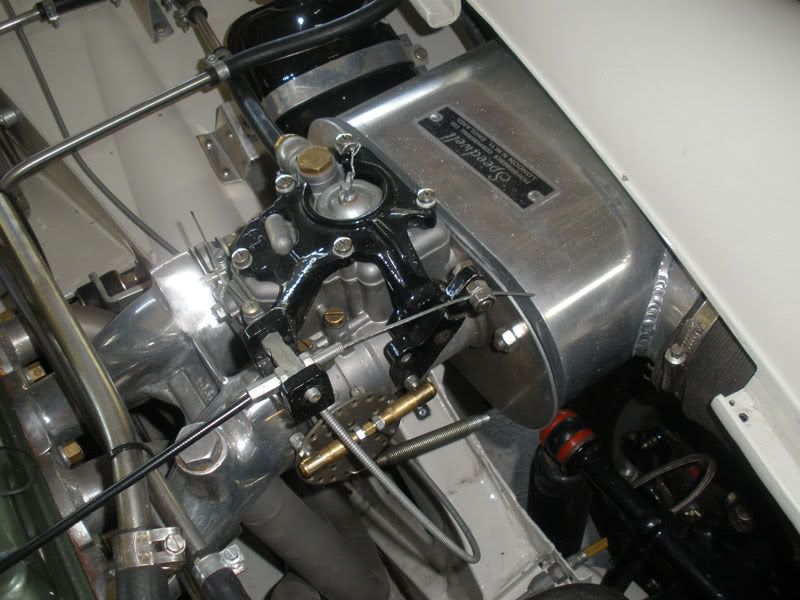

JanSpeed (SU or Weber):
DBilas (german manufacturer, rare piece of kit):
But in both cases I belive reduction of intake noise was the main concern :)
Jan
