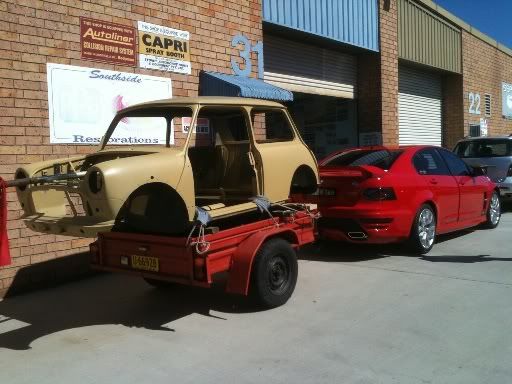

You would mean like this?
Just make sure the 2 x pieces of 100 x 50 are securely tied to the trailer and then the body shell is tied tightly to the trailer

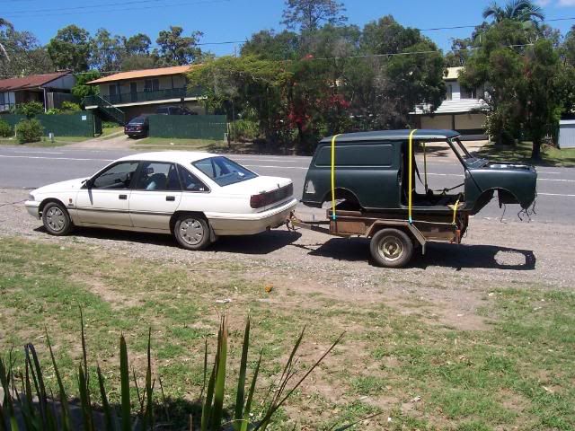

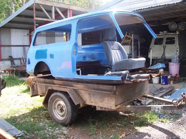

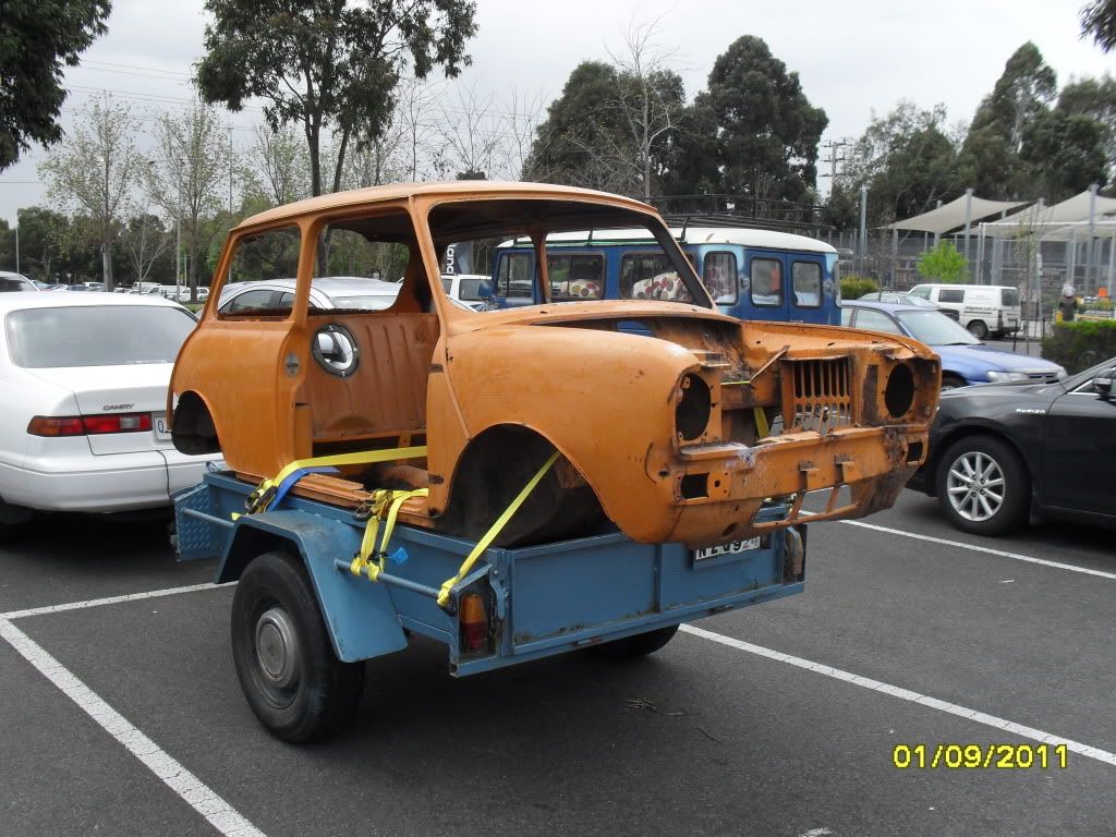

PostPosted: Sat Sep 10, 2011 12:46 am
Here's some of mine;
mini van without front cut.
another van
and a sedan
You'll see the sedan floor pan fits inside the top of the trailer to help locate it to prevent it moving around, the vans are a bit to long for this to work as well.
