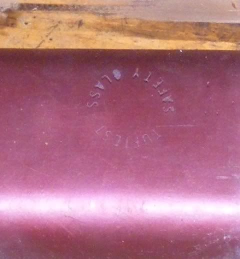

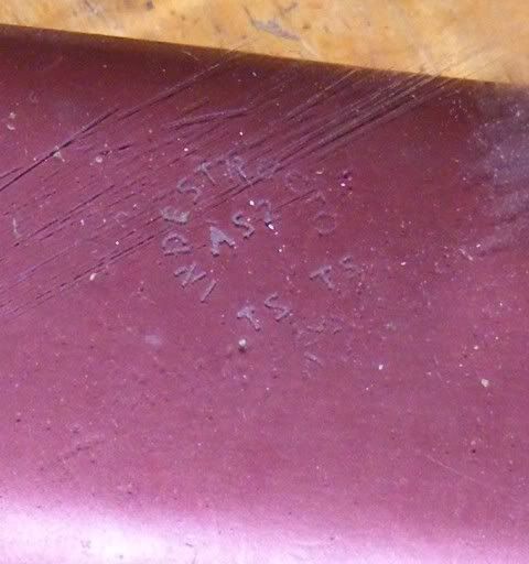

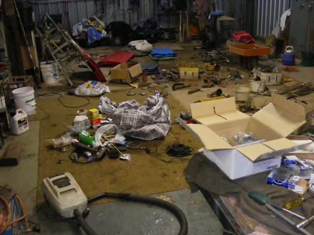

We have just arrived home with this car in bits, which includes some windup window bits. (Mary Loo)
On the ID plate...YMA2S1
Car Num..9/28832/756
Engine Num.....8AM/U/H/104632
Colour...1/ORIENT RED/3
Mary Loo would like her right glass. As we can not read/date the glass, hoping someone can do it for us.
The fuse holder is the only dated part we can fined with the bits.

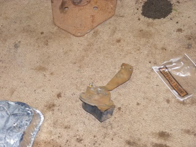

While we are looking for help. This horn came out of the bits. It has a mounting bracket which would fit a Mini, but horn is different and part plastic, Is it likely to belong to a Mini.

Congratulations. One of the the oldest Australian assembled 850 existing. In fact car number 251 if I'm not mistaken.
Probably a sister car to mine (also Orient Red) and assembled at the same time from 1960 UK CKD kits or semi completed cars. See date of August 1960 on fuse box. It will have many of the very early features like the front floor pan pressing which allows water entry, slotted holes for the front roof drains, early seat mounts, thin rear quarter light catches, brass door hinges etc etc. I still believe that these early cars may have been delivered to Australia part assembled and not necessarily in kit form and used to test the market and press release cars (see Modern Motor May 1961). Either way 850s were here well before their release in 1961 to assist BMC Australia with their assembly/production facilities and training. That didn't happen in a matter of months. Early cars must have arrived here in late 1960.
Should definitely have sliding windows not wind up. Dates on steering rack, radiator, all Lucas bits incl switches.
Let me know if you want more info about these early 850s.
BTW
Dot above X in Triplex shows 4th quarter ie Oct to Dec
No dot below Toughened is 0 ie 1960
Good luck

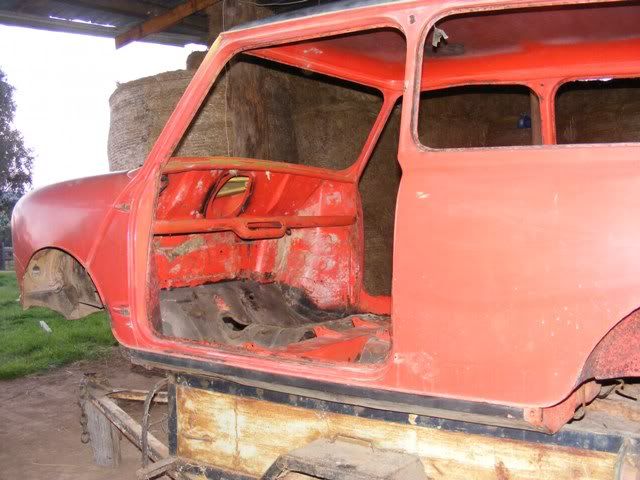

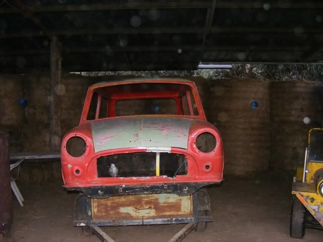

mini_fanatic wrote:
Is there any possiblity of more photos? I'm interested in the early 850s.
Is the body amoung the bits somewhere?
Evan.
Here you go!
