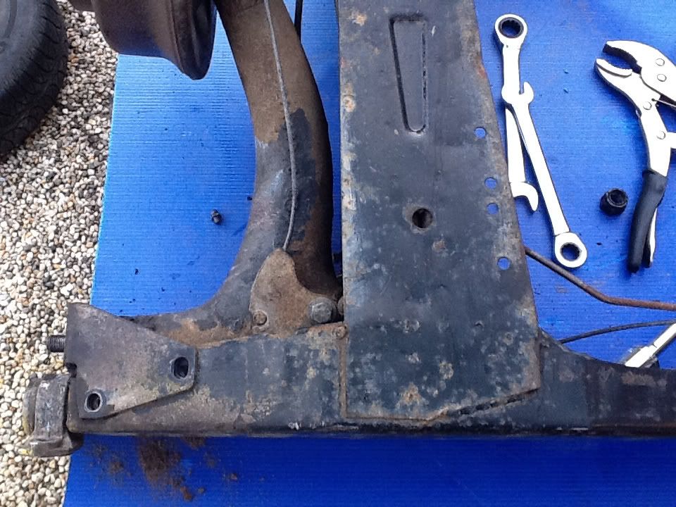

Hi guys, i have started stripping my rear subframe and i'm stuck on how to get this pin out, can i just bash it out with a hammer or is there a trick to it? I know it is a bit of a noob question but i just want to be sure so i dont kill any bits.
From this view do i bash it to the left or the right?
Cheers guys, thanks in advance
PostPosted: Tue Sep 27, 2011 5:12 pm
Posts: 722
There is no need to Bash anything...
You have to remove that outer bracket.
You have already removed two of the bolts.
There are two more bolts holding it to the subframe.
They are located above and below the shaft, inserted in the opposite direction to the two you have already removed.
They are probably hidden by grease and dirt.
Have a dig around with a screw driver and you will find them....
Good Luck,
Dave

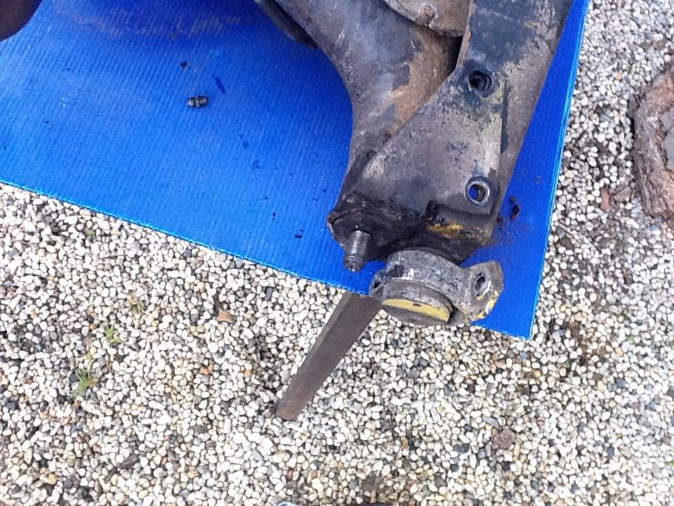

Here is a pic of the bracket, should give you an idea where the bolts are....

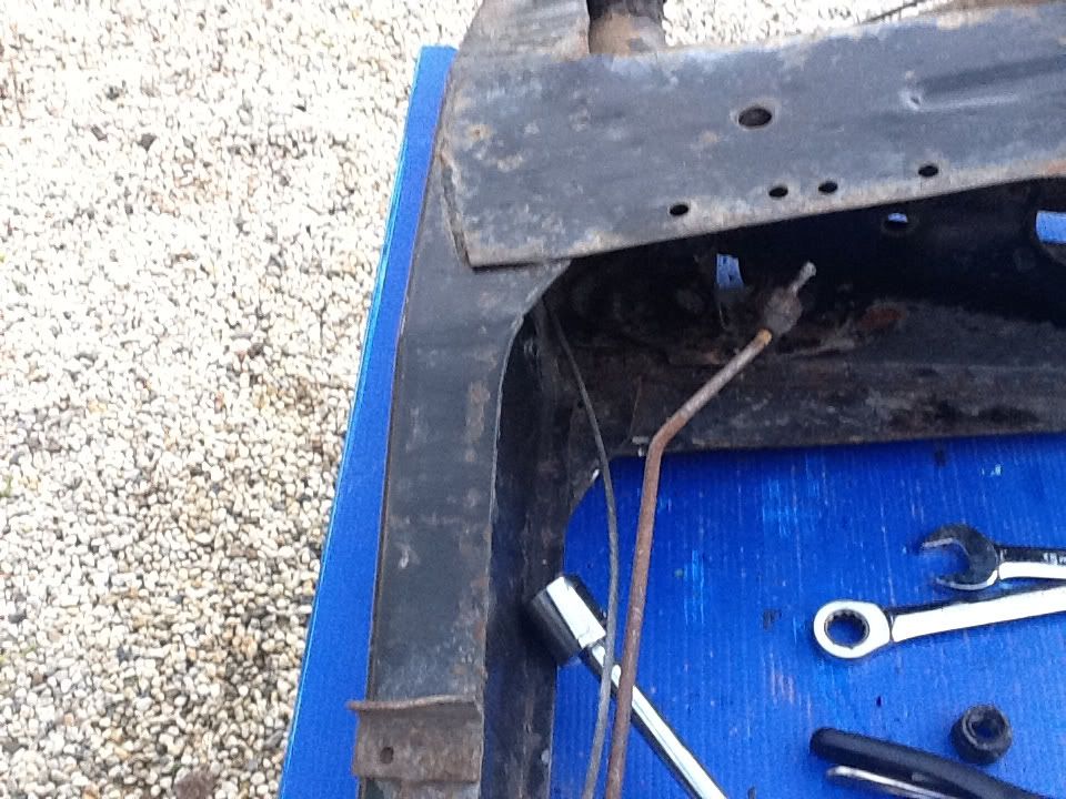

Now how do you take the handbrake cable out?
PostPosted: Tue Sep 27, 2011 6:10 pm
Posts: 633
I stumbled on the same thing, hidden under all that grease.
The handbrake cable is just held down by bent tabs, just bend them up a little and pull it out.
PostPosted: Tue Sep 27, 2011 6:16 pm
Posts: 805
Location: Doncaster, Vic
Are these the tabs?
PostPosted: Tue Sep 27, 2011 6:24 pm
Posts: 3166
Correct
And you can also spread the corner wedge pieces so you can pull the cable out of these as well

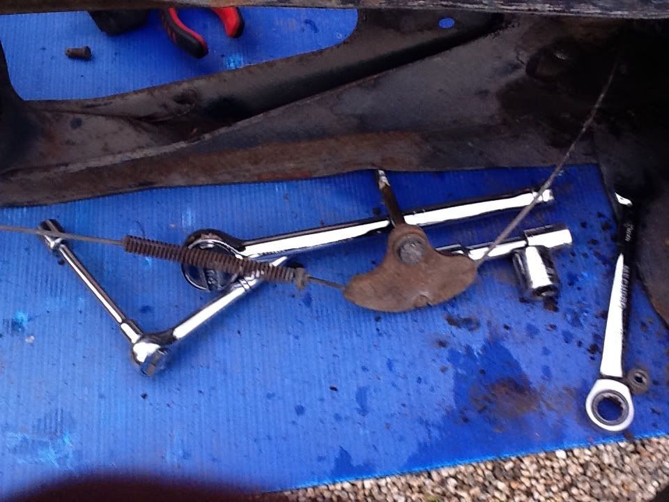

When you re-install the handbrake quadrants (top pic of handbrake cable) just remember that they are not symmetric (look carefully) and will easily install the wrong way 'round.
And if you do, the handbrake just won't work.....
