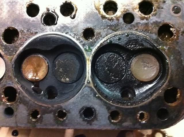

For a long time I've suspected that I've been burning oil leaking past the valve guides on either #3 or #4 (or both). The plugs in those are always oily, and on long freeway runs I tend to use half a litre of oil to every tank of fuel :shock:
Since it has never blown any smoke to speak of under load, I figured it's not the rings and lately it's been getting increasingly hard to start when cold, running on two or three cylinders for a minute or two as it cleared the oil from the cylinders.
The last straw broke a week or two ago when reversing down the lane from the garage, into a small cloud of blue smoke...
So this evening I gave it a headectomy, and this is what I found...
Nos #1 and #2:
Nos #3 and #4:
Number 3, the smoking gun...
Cylinder #1:
Cylinders #2 & #3:
Cylinder #4:
Lots of carbon buildup on #3 piston from all the oil, this probably explains the run-on too.
So, time for a freshen-up :)
Can anyone recommend a head shop in inner-west Melbourne?

Mate, that's not (much) carbon build up... You should see what my pistons had when 1018cc and I pulled the head the other week. :mrgreen: You've got less on all 4 pistons than I had on one! :P :lol: And that was without oil leaks - all just from running rich. :lol: :oops:
Good luck with it. :)

Well, lots on #3 compared to the rest of them :lol:
I'm actually pretty pleased with the state of the pistons & cylinders, I've not had the head off this thing in 10 years since it was rebuilt. No measurable lip on the bores, they look brand new 8)
