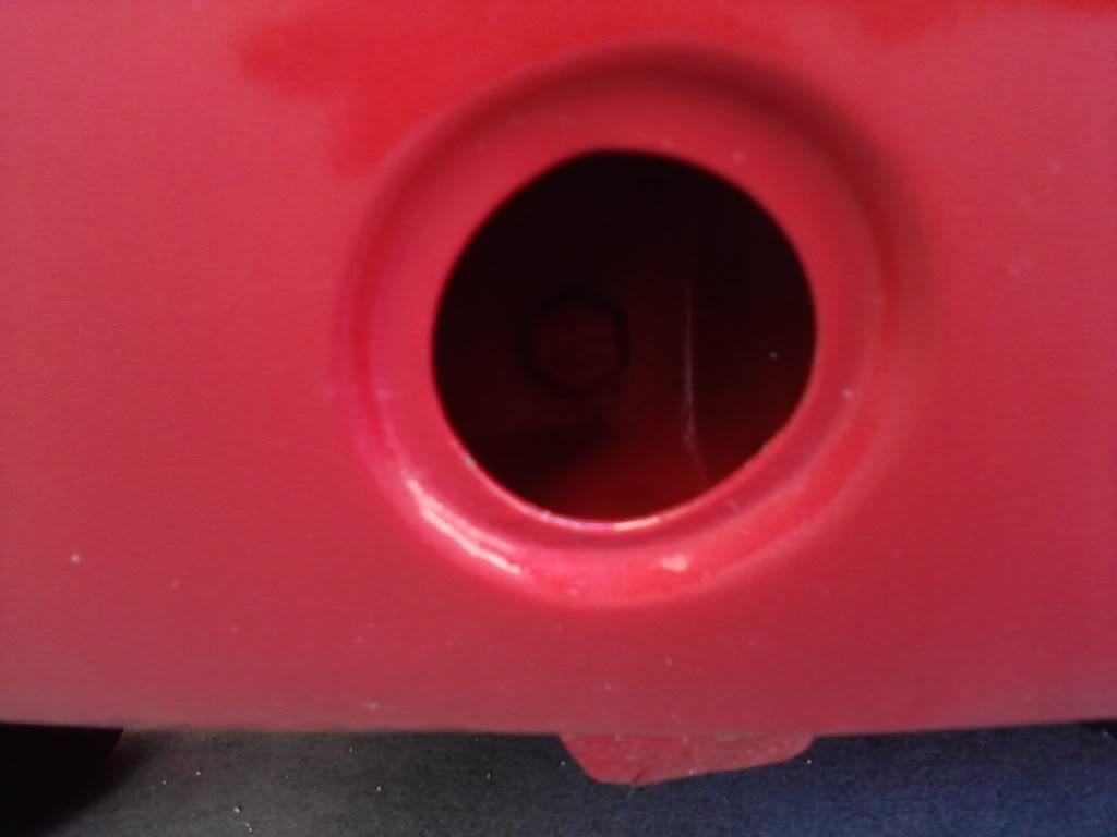

How do you guys support the subframe when you put tow hooks in as they fit into the front subframe mounting points?
this is the spot people put tow hooks correct?
And does anyone know the size of the bolt in the first picture?
Cheers, Rhys.

I think normally that bolt is a 5/16 UNF.
What I didn with my car was put a 3/8 UNF bolt through that hole, from the back, and I have a 3/8 towhook that screws to that.

The bolt has A UNF on it with three lines.
Whats this mean?
Do these bolts actually hold the subframe in at the front? Or do they just help hold the front apron on?

Well they hold the subframe and front panel together ...and vice versa :)
Some cars came with eye bolts from the factory.
Just take the plain bolt out and fit your tow hook. Nothing will move...

So it should be fine to whip one out in the morning and take it with me for size matching?
And nothing will move.

Yes, it will be fine if you don't drive that car. I wouldn't drive with it like that as the front panel may flex.
Don't get the cheap ones from Bunnings etc. They are designed for plants not cars and bend or break very easily! Proper Mini ones are much stronger.

3 lines = it's a Grade 5 hi-tensile bolt. [fyi, 6 lines = grade 8]
Yes they hold the subframe to the body, which adds some rigidity to it.
