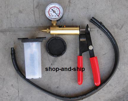

Use a vacuum pump. No mess, and no pedal pumping required.
e.g. http://www.ebay.com.au/itm/ATV-UTV-MOTO-GO-Cart-BRAKE-BLEEDER-VACUUM-PUMP-KIT-set-/220864535088?pt=Motors_ATV_Parts_Accessories&hash=item336c8d5a30
Also great for testing for vacuum leaks.

I've found those vacuum pumps are great.... until all the gunk in the fluid you just bled blocks it all up and you need to clean it out. Can't say thats for all of them on the market, but i know it happens with the one i bought.
