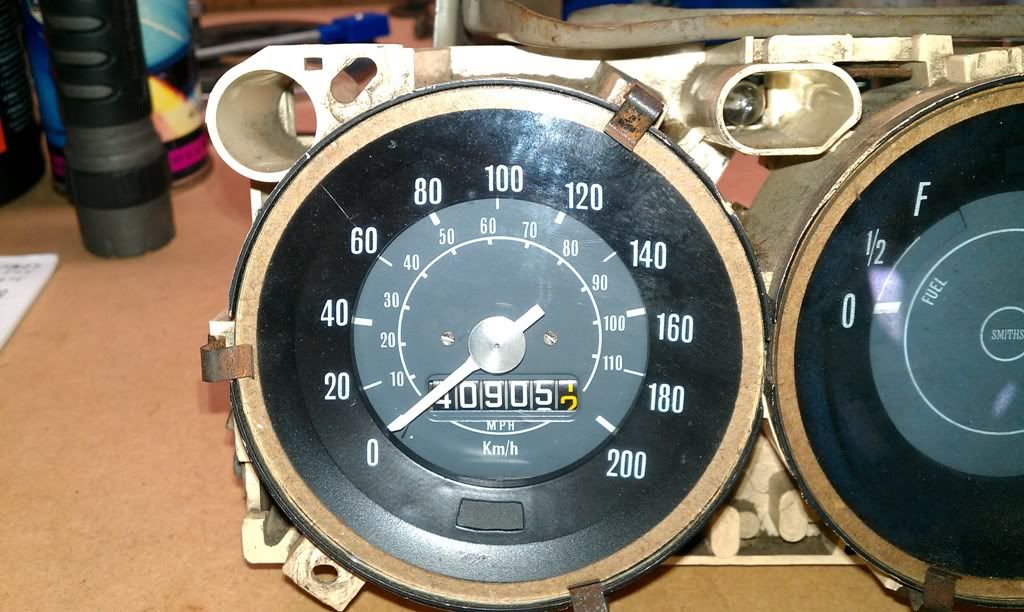

I may have labelled the tread wrong, as the speedo actually works when spun, ie it give a kph reading, however the odometer fails to turn for the obvious of missing gears.
Doc as you can see on the 3rd photo down it's a 780 TPK/TPM, which is why I included that photo. Do you know if the drive gears for the odometer are common across the Aus speedos?

Yep it is 780 turns/km, = 1263 turns/mile. = near enough for a 3.44 diff (Cooper S was 1280).
All the odometers work in a similar fashion (ratchet and pawl) the differences are in the worm gear (you can see) and the driven gear + pawl it drives (I can't see).
I would pack it off to a speedo place for repair.
[edit] If you can find a late Oz Clubby 998 speedo (they used 3.44 diff mostly) rob these bits from it..

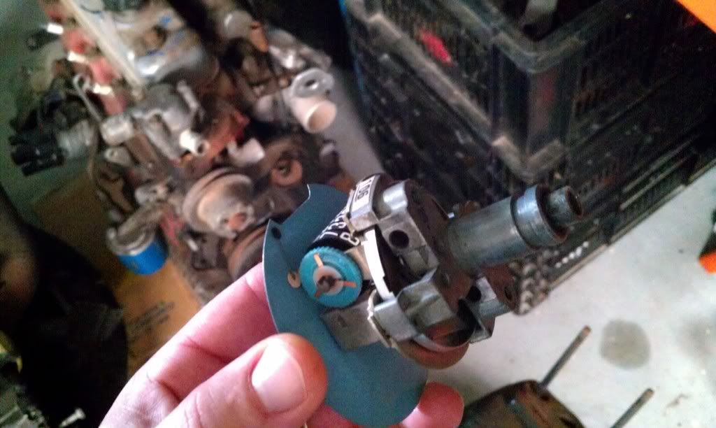

Heres a pic of a OZ speedo
looks like a cam is mssing on yours

I have found a OZ Speedo in a box of bits if you want a pic of the cam etc
PostPosted: Wed Nov 02, 2011 2:53 am
Posts: 376
Hi kiwiinwgtn, pics would be great! Guess-works don't really have a photo that I can see.
Cheers Shane
PostPosted: Wed Nov 02, 2011 6:52 pm
Posts: 1347
Location: Wellington,
hope this helps
