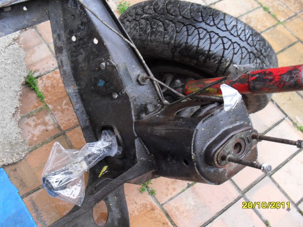

i would give a discription but a picture says 1000 words
i cant undo the nut as it is on radically tight,

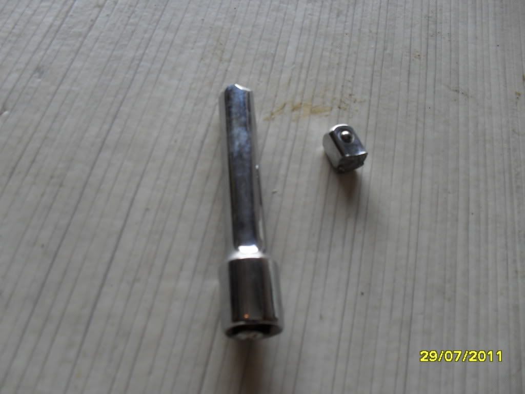

the only time i thought i got close this happened
i have used a lot of wd40, tried using multigrips but they just cant hold it, i have also tried with a rattle gun with no success.
plz help
thanks Matt,

Which nut are you talking about?
If its the CV one I've had a few drum ones sieze up completely and destroy everything getting them off, however I thought I'd check the obvious: is that the wheel with the backwards thread nut?

yer it is the one to get the cv joint out, i thought the rear hub nut was the only one with the reverse thread? if it is a reverse thread thats awkward for me.

Why the use of the extension bar? That will always be a weak point undoing a hellishly tight nut.
I think I got up to a 2 meter bar once on a rusted old one.
