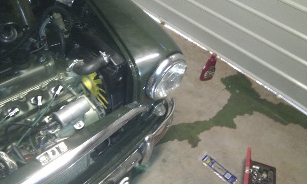

Fixed my timing cover seals and refitted the radiator, and must have damaged it... Yay new Radiator time!

nah, coming out the actual radiator in the middle
