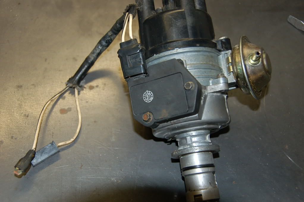

Hi All,
Have electronic A+ distributors with two wires comming out.
One white.
One white with black trace.
Where do the wires go?
Are some of these distributors disigned for a coil with a resistor?
Thanks
PostPosted: Thu Nov 24, 2011 9:13 pm
Posts: 860
Hi all,
This is the distributor.
One white wire
Where do they go?
I assume one is the negative side of the coil, and the other is positive - but which is which? I don't want to assume and then fry the little balck box.

On mine the all-white goes to the positive and the white with black line goes to negative. I can't seem to find my Haynes Metro manual to scan the diagram.
It may be the case that your distributor has male connectors on one terminal and female on the other. This is often a good check too.

I think your right. I have the same a+ dizzy and the 2 wires have different sPades . Male and female. Should match up to your coil. My white/blk trace goes to neg side of coil.

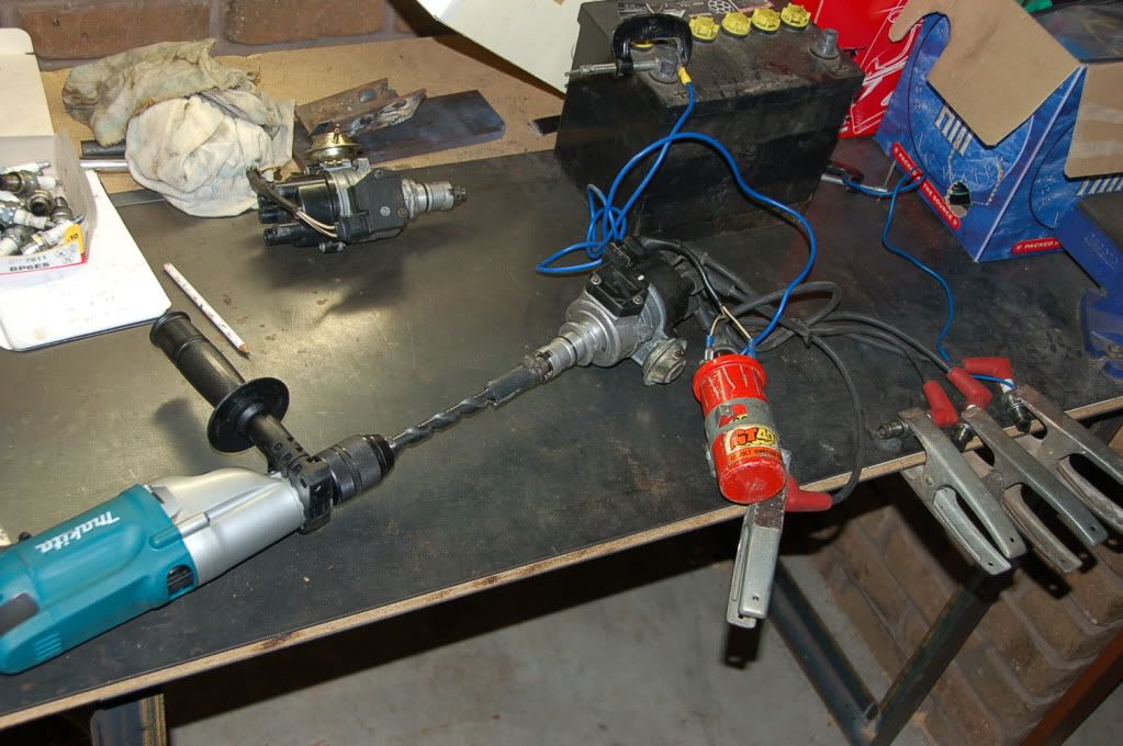

Tested the distributors on the bench - all OK

Yep, white/black goes to neg side of coil, white to pos side :)
