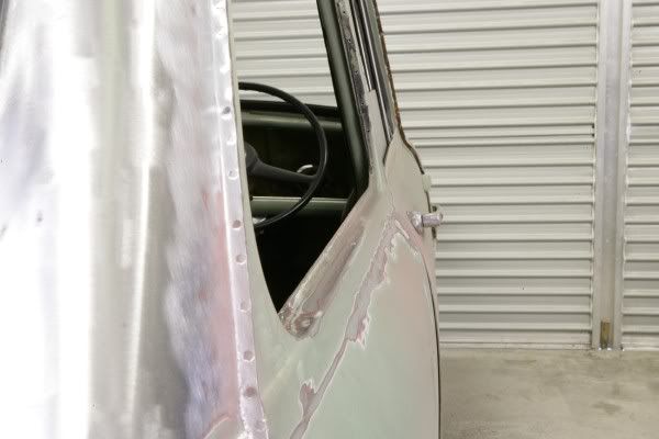

I would expect more air to be held together with copious amounts of iron oxide especially along the rear windows...unless this mini was really driven by one careful lady owner. However, the 'Xtreme MSport' sticker across the back window says otherwise.
So...is there any way to tell if panels have been replaced?

no reason for them not to be original...
leylands rust there, roundies not so much

Any particular reason for that? I find the lack of rust astonishing for such a car. My '76 roundy in the UK had more!

Up until ~1973 when Minis moved to Enfield plant, all Minis made here (at Zetland) got rotodipped before painting.
We don't salt the roads here either like in UK.

ah.. that explains it
it's rare, but not unusual to find an original car that's lived in the middle of nowhere with no rust at all - and I mean none
plenty of cars are scrapped that are seen as too far gone out here would be seen as an easy job in UK
edit: put up a picture of the spot welds along the top of the mudguards, under where the sides of the bonnet are - it's usually easy to tell if they've been replaced, but chances are they're original
