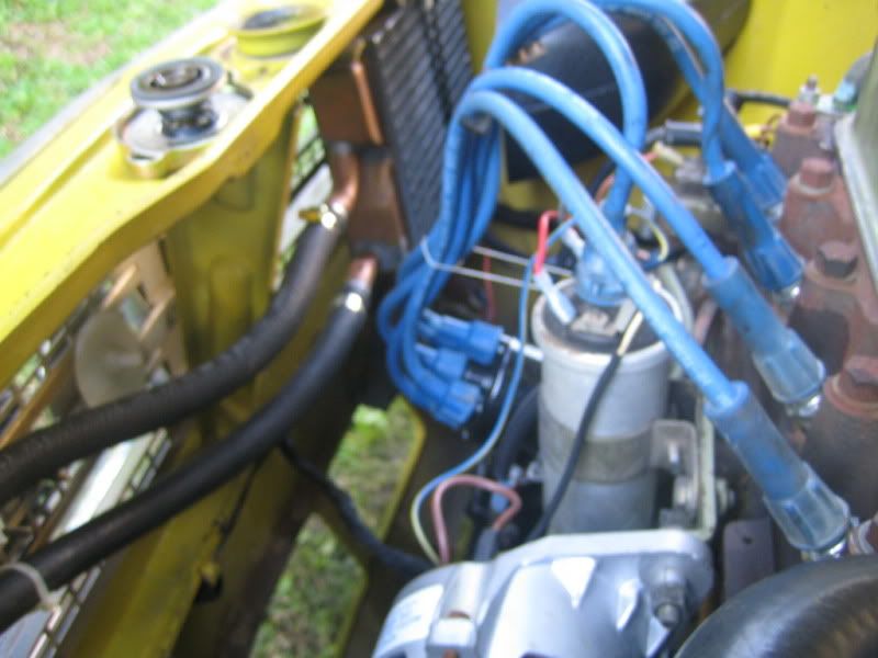

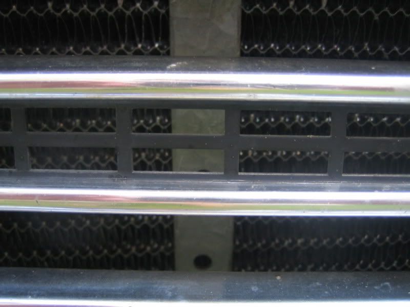

ROO the '73 Clubman Window Van had a new radiator, new water pump, new thermostat/hoses/belt and...an auxilliary radiator.
Emphasis is on used rad/pump in good nick, if not new.
NO OVERHEATING with the 1098 pulling a heavily loaded Mini.
In fact, ran just below normal except on the hot dash from Kunnunura to Broome...when the needle sat on N.
I used a new GM pickup heater core (brought with me from Canada) as this setup has done the job in the hottest parts of North America.
Photo: setup in Clubman Van

I have a few cooling issues of late and will have to look at most of what has been discussed on this thread. Might start my own as not to hijack once im down the track. Brown vinegar ... Really???
I would like to track down a heater core where can i get one?
My guess was that they the hoses connect into the top and bottom radiator hoses??
PostPosted: Fri Dec 02, 2011 2:59 pm
You can get a heater core from a wreckers. Different cars have differently shaped and sized outlet pipes.
They hook into the heater hose that comes out the clutch end of the head.
