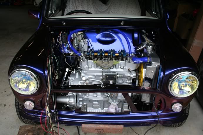

Has any one installed the Minisport Smootha ride kit?
My car is sitting way too high at the front and the hi-los are adjusted all the way down.
ImageThe rears are OK.
I fitted the engine today but its is still way too high. :(
1969 Cooper "S"
1967 Mini Deluxe
2019 MINI F55 Cooper S
PostPosted: Sun Dec 18, 2011 8:55 pm
Posts: 3135
What about putting an engine init. :lol:
By the way looks beautiful with the white interior. 8)
<Edit> just read the bottom line...You have put the engine in it. :oops:
PostPosted: Sun Dec 18, 2011 9:01 pm
Posts: 3166
Yep engine is in and it is still way to high
Didnt seem to compress the donuts much when I dropped the engine in :?

fit the engine and gearbox then worry about it, too many xmas drinks Micheal

How high is it with the flairs fitted?
i mean cause the guards are cut it will make it look higher.

sorry Micheal seems comments and photos went at the same time , never had a problem with a body sitting too high only too low, hope you cut the the front guards correctly.

oops,,, how did that picture get there???

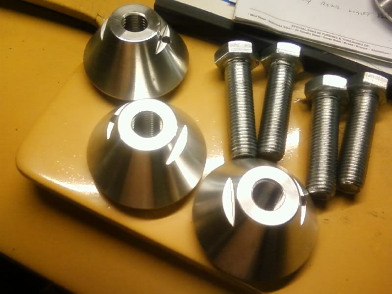

I grabbed this image from your other thread, I assume this is the kit?
If so, what I'd do is remove the locknuts from the front cones and run them that bit more shorter, over time you can wind them back out if necessary.

PostPosted: Mon Dec 19, 2011 10:09 am
Posts: 3166
Yes I think the hi-lo kits are the same between front and back. But I will double check and yes I think I might remove the lock nut for a while until it settles down.
