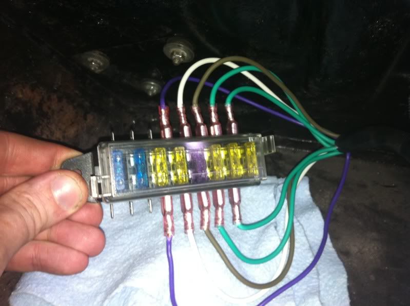

Ok so my latest hick up is as follows.
finaly got car runing so the major hurdel is done.
now im paying my attention to the electrical system witch is a bit confusing.
The wiring loom i had made up is for a
plus i had it wired with other stuff i needed to suit my gauges etc plus other stuff like rear reversing light ...and my washer bottle is located in the boot also
thermo fan etc
now the thermo fan is working fine but ive got nothing going to the wires that are for the washer pump and the pump is brand new as i tested it on 12v battery but no power is going to the wires in the boot.
also my fuse block is new and the wires are a bit werid.
see photo.
its got
x 2 green
x1 white
x1 brown
x1 purple
the only one that is live is the brown one that gives power to the ignition i think?
I have no idear what the others are for and none of them are gettign power anyway?
also after i installed the rear loom i noticed it has wires named reversing light as i told them i intened to put one onto the boot at some stage once i find the right one from uk
so i was like ok thats good but instead of putting the end to this in the car near the dash switchs as i said i wanted it to be able to be turned on by a switch the wires are located at the front of the car near the radiator ??
so now i have to relocate them to suit ...bugger
also on closer inspection i cant seem to find the wires that go to the brake light switch on the subframe??
theres none built into the loom?
I would think all minis have this switch located here so any idears what to do with this missing bit of loom?

that fuse box will never work as it is at the moment.
which wire comes from the Battery/ Solonoid terminal to power the Fuse Block??
The top row should all be connected IN SERIES to Positive power IN,the fuse exit wires going to the respective circuit switches...then onto the "thing" being powered up.

I wired it like that as none of the wires were labeld on this part of the loom all i was told was that they were for the fuse box.
the only one that is live is the brown wire so if im understanding you right all other wires need a possitive currunt going to them?
gues thats why none of the other stuff is working lol
ill take a closer look at it today....any idears how to wire it up so part of the fuse box is all live?? i had this problem last time so i made my own fuse box and wires it so the whol box was all possitive by soldrering all the conectors together on one whole side...
should i do this again?
or do they make a fuse box for this purpose?

Use the original Lucas fusebox!!! The fusebox you currently have is useless and will continue to give you strife. Nothing wrong with the Lucas 2 fuse box - you can get them new and they have the right number of contact to do the job. Clean the contacts thoroughly on an old one and tension the fuse holders and you're sorted!
From memory,
White to 1
All green to 2
Brown to 3
All purple to 4

IF the makers of the loom followed the normal colour coding for English cars Then:
Brown is Battery +
White is Ignition switched
Green is fused protected ignition circuits (brake lights, wipers, instruments, blinker etc)
Purple is fuse protected Battery + circuits (Horn etc)
Sort the fuse box first then check which wire to the instruments have ignition power. Hopefully they followed with green for ign, black for earth and a suitable colour for the senders.
