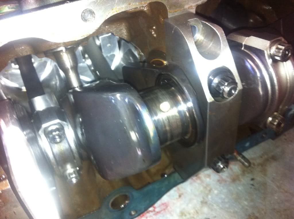

Ok so i need to get a crank ground ...
its currently on -20 on the mains and -20 on the big ends ..
sooooo my question is how far can you safely take a crank that is going to be abbused ( 8000 rpm )
im hoping my damage will clean up at another 10 tho ( i ran the engine with low oil and the preassure dropped )
the crank in question is a cooper s crank..
Thanks

My spare 20/20 EN40B S crank suffered the same fate on a track day, and just cleaned up at -.030" on the mains.
Failure was due to insufficient crank endfloat (.003")- I've learned my lesson, I now run .007" on both my 1275 cranks.
IMO the size & quality of the corner fillet radii is more important than the undersize, if you are going to rev it....

The factory only recommend -0.020" on the Mains and -0.040" on the Big Ends. Now, this is what the factory say. You can take both of them down to -0.040" on each and bearings are fairly readily available, but it is outside factory recommendations. I ran one at -0.040 on both for ages, but I didn't try to kill it either.
Plenty of people have taken them small than even this and Most of the time you can get away with it. Bigger is usually better though.

Have just spoken to the Machinest and the crank has a 6 tho run out in it ... they hope it will clean up with going -10 under and 2tho clearance ..
Here's hoping that that works .. if not got a new crank to buy :cry:
all this because the rocker cover gasket failed ...
i mannaged to pump 3 litres of oil out of the rocker cover in 8 laps ..
