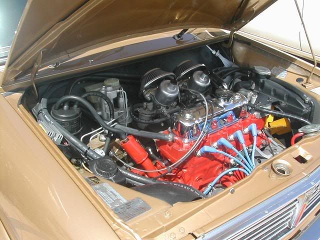

Hi,
I used a core from a HJ or similar Holden.
Purchased it new and had the outlets changed to 1/2 inch, and had my brackets soldered on at the local radiator shop. About $75 all up and works a treat.
Plumbed it into the heater circuit, which does not have a tap.

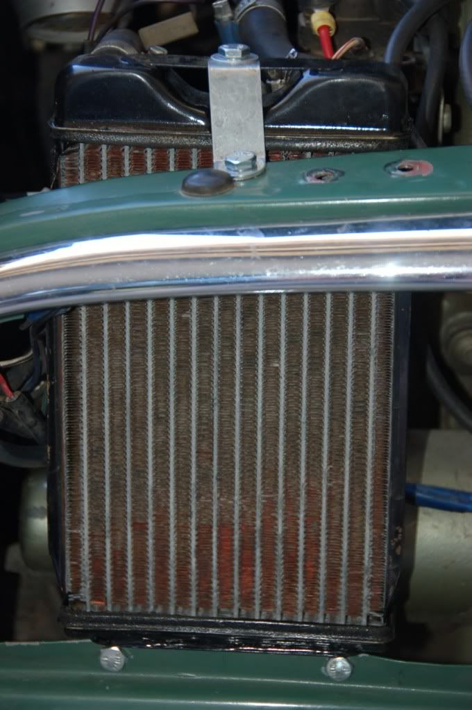

I like that very neat. I would have the inlet of the shown extra cooler coming from the heater take off in the head (next to #4) and then going back into the top tank of ther radiator,( yes this has to be done by a radiator shop]. Blank off the bypass hose, drill holes around the outside of the thermostat and Robert's your mothers brother.

I used a clubman heater core in the past as I had a few laying around. Worked well.
Brett Nicholson
Greendale (near Ballan) VIC.
1971 Morris Mini Moke
1966 Austin Mini
1965 Morris Mini Traveller
1973 LR Series 3 88
2007 LR Freelander 2
PostPosted: Sat Jan 21, 2012 11:04 am
Yep we put a Clubby core in my mate's Cooper S similar to pic above ^^. Works a treat.

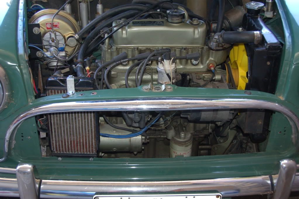

Pic of Clubby heater core fitted to LS-works well in 30plus hot days in Perth .

Okay-Another pic: I'm guessing that you have the same radiator(Clubmans)with the heater outlet coming from the radiator(ie steel pipe-look closely at the pic). If you look again at the pick-there are two outlets coming from the additional heater core.Route your hoses along the firewall(see pic).
One goes to the cylinder head(get rid of your heater tap).
The other goes to the steel pipe coming out of the radiator.
Hope that helps.

Any heater core will do but some are more robust than others.
Clubby core is not too big, and the tanks are pretty solid.
It really doesn't matter which hose goes to the head, it'll work either way as it's being pumped.
