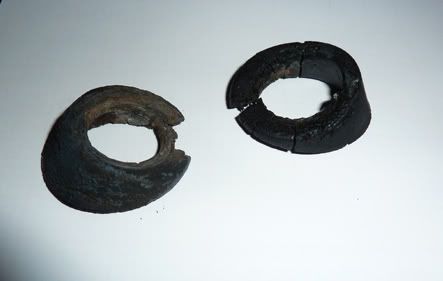

PostPosted: Thu Feb 23, 2012 8:09 pm
Posts: 541
Location: Ocean Grove, Vic
are these the things your talking about doc? As you can see mine are....well......past their best before date. They look like they might have been rubber once
If they arent what your talking about, what are these things called as i need to order some new ones

PostPosted: Thu Feb 23, 2012 9:52 pm
Posts: 39764
Yes that is them.
I call them `wiper escutcheons', early long tapered ones are easy to get as they are the same as UK ones.
Late ones used only on Oz cars from `68 on (with the recessed holes in the scuttle panel) are p/no 62710622. Official name is `bush'.
[edit] I think these late bushes are NLA except for the ones I make. I attempted to buy a pair from ******* Motoring once, but when they turned up they were the early type.
Some people cut those back to use on late cars, but they are too small to seal properly.
As I said Mini King has both types, material of these is HDPE plastic, machined all over. More durable than the originals.
