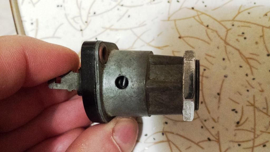

With your switch, you will need to insert a pointy thing into the hole that is shown in your 2nd pic to be able to get the barrel out. If unclear just ask :)

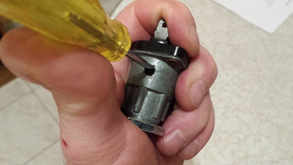

OK-I've read the How To section where it mentions that you need to push down the little gold circlip thingy (top thing shown in the hole)
The gold thing in my lock sits above a spring and I've pushed it down (toward the keyhole) and I've pushed it in every other direction but it only moves with the spring toward the keyhole. Is it meant to move in any other direction as the barrel has not budged?

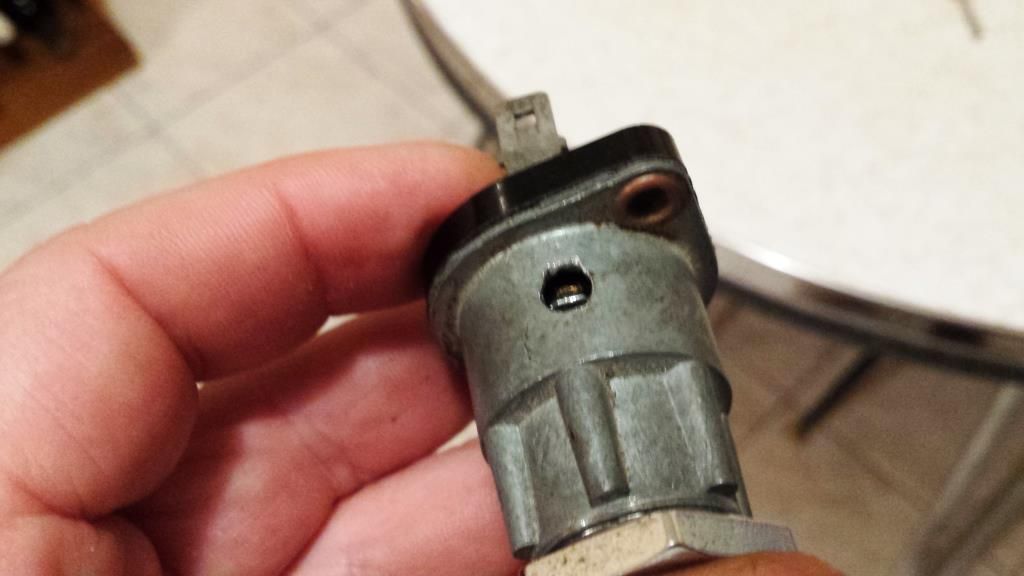

I may be able to help as I just pulled one apart.
Look in the hole you have been poking your screwdriver in.
Between the coils of the big Spring you will see a little hole or depression.
Poke a small philip head screwdriver in to depress the locking pin that is in the lock barrel.
With your third hand pull the lock barrel out.

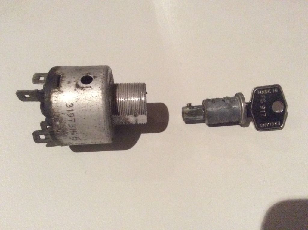

You can see the locking pin sticking up out of the tail of the barrel in this photo.
That is the bit that you have to push in, then pull the barrel out.
