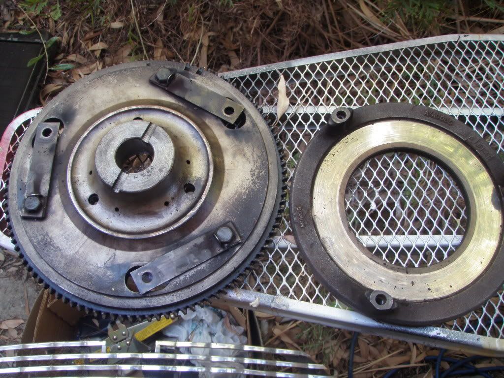

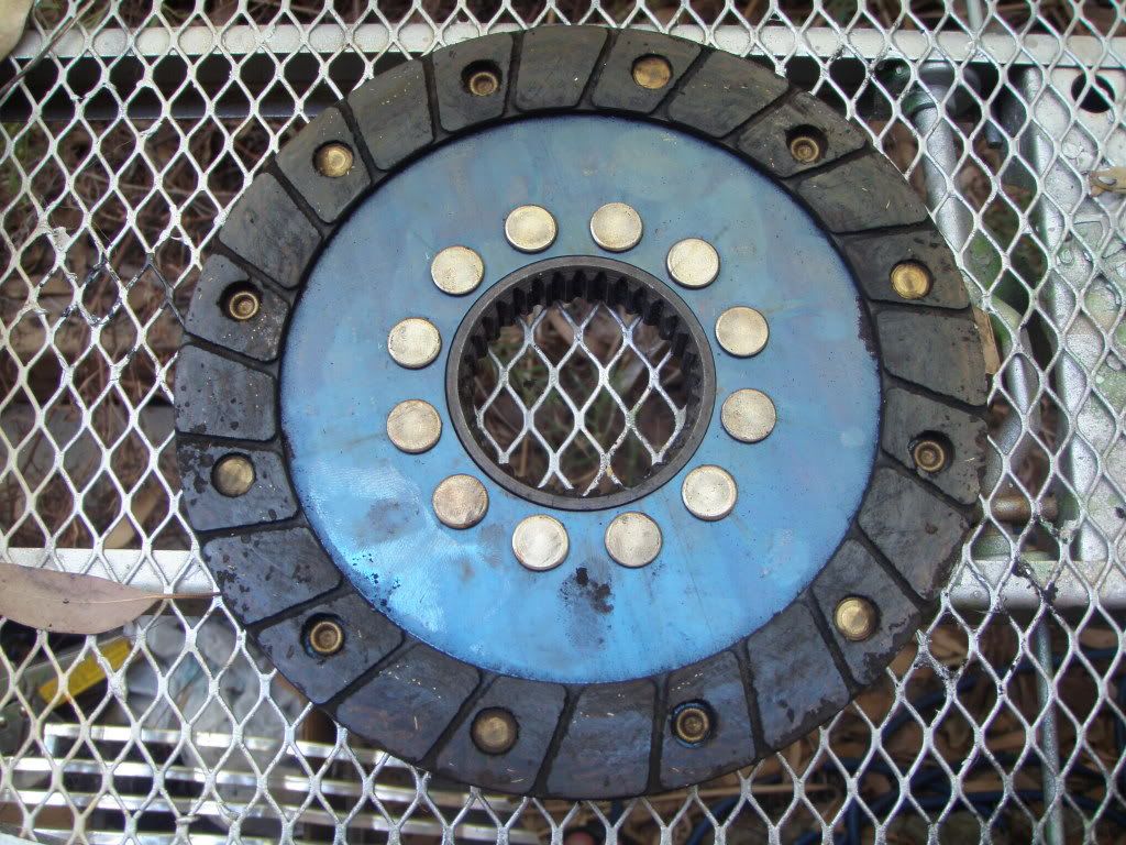

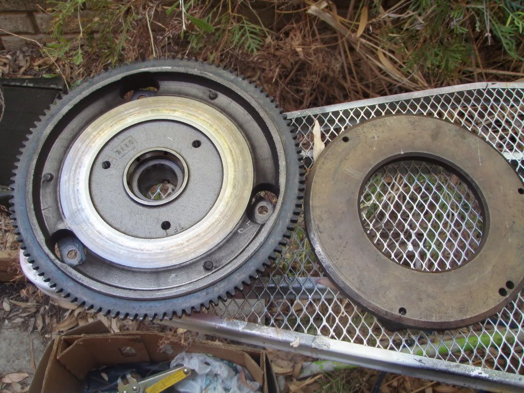

I bought the flywheel puller tool and took it all apart. Here are some pictures. Does the clutch look bad? I dont know what a bad one looks like.
If anyone could advise me on what needs doing, and what parts to buy that would be great! I dont want to buy the wrong clutch etc in case this has been modified somewhat.
Thanks again!!
PostPosted: Wed Mar 14, 2012 4:32 pm
looks fine... what about the diaphragm (the hat that goes on the outside) look like? is the spring in there OK?

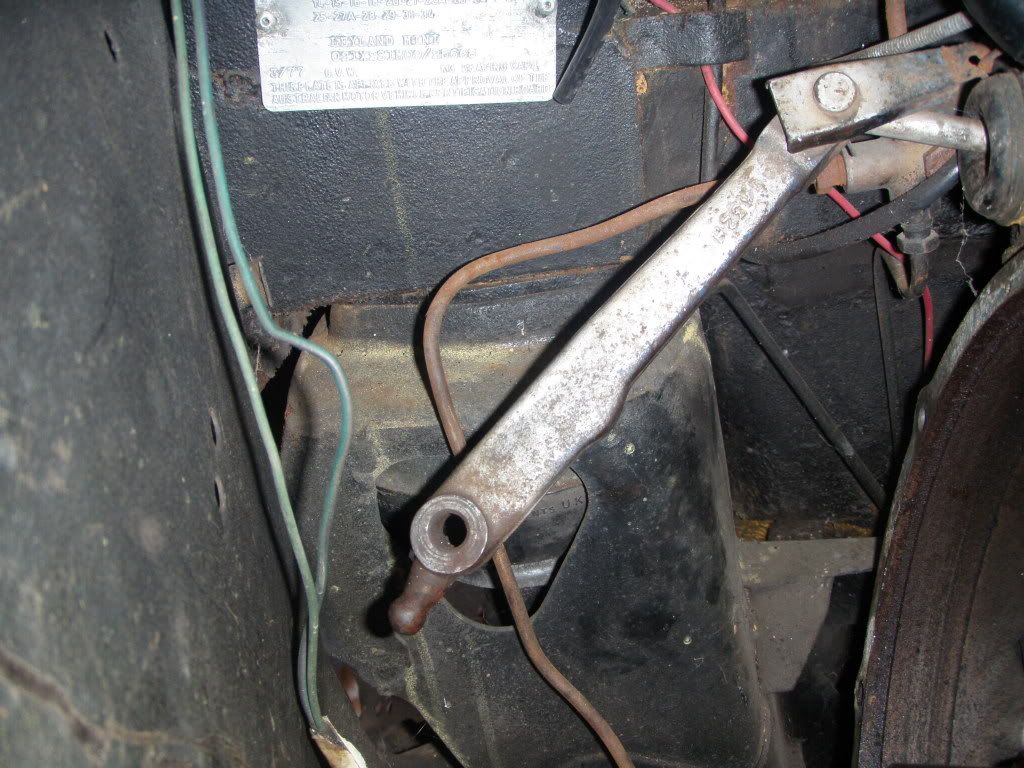

how does the arm look? looks straight to me?

I though the clutch plate didn't have a great dela of wear on it but it did have a fair amount of oil - particularly in the second plate photo.
Regardless - as a matter of routine. if you changing a clutch, change the oil seal as well.

Check that the diaphragm spring is flat (ie parallel to the flywheel) when the clutch is assembled on the bench.
If it's less than flat (typical with old clutch assemblies) you are not getting max clamping force.
I have seen a 1275LS one so far out, it slipped in 4th gear with the clutch plate only worn 0.5mm.
[edit] I check flatness by placing a 3mm drill against the spring (you can do this in 3 places) and eyeballing that it is parallel to the flywheel (or not quite).

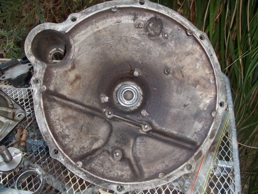

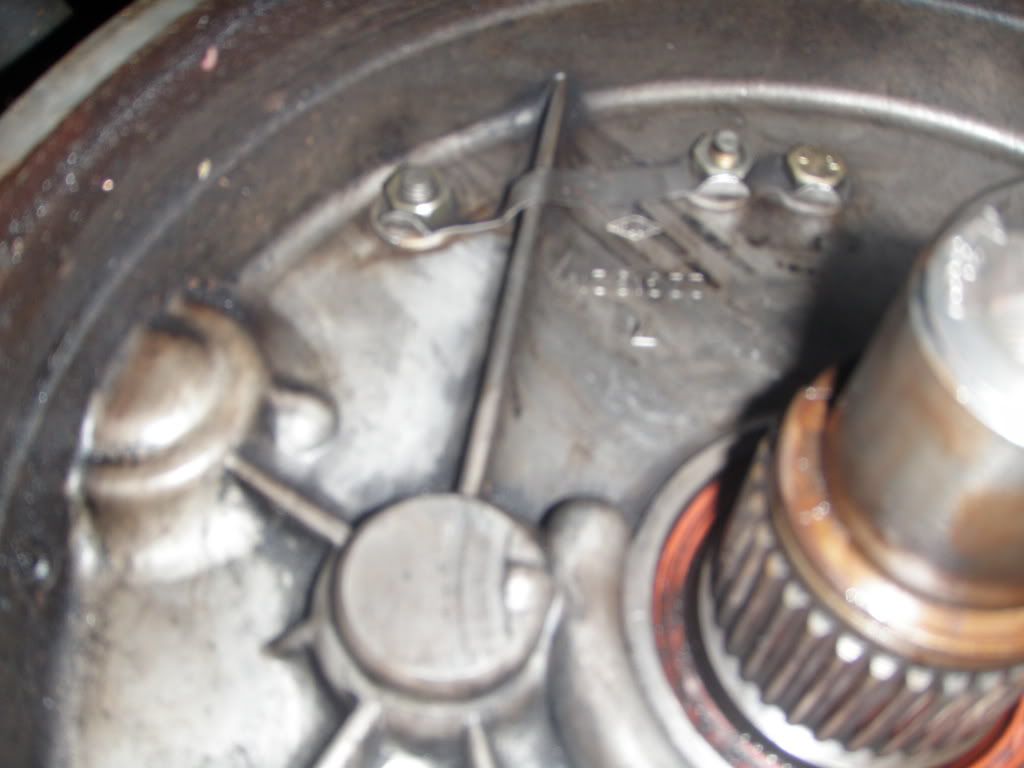

I reckon the seal was leaking there'd be more oil around than that, it might be best leaving the seal alone... Can you post a picture of the engine side of the clutch housing, so we can see the crank & seal area? and is there oil sitting in the bottom? (there's a ~5mm hole there designed to let any oil out)

why thankyou simon. Well if you think this seal is leaking i'll give it a go... otherwise might be best to leave it . Do you think its worth replacing the clutch?
I hope these pics are ok
PostPosted: Wed Mar 14, 2012 8:30 pm
Posts: 39757
That seal looks good, not dripping- or have you cleaned it all up?
