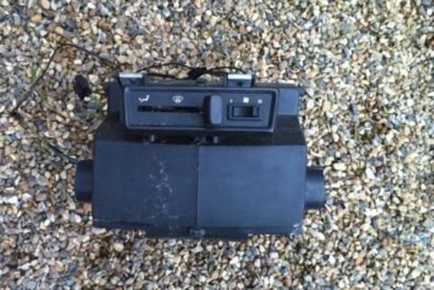

I don't think it's the same as that one in the pic. Here's a pic of it.
This is the one I'm about to buy. The fresh air one could be an option nut would prefer this one though.

Dimensionally the casing is pretty much the same. It just looks a little different. It will clear the gearstick.
If you are really concerned, get NG to send you the dimensions of this one and I will compare the dimensions with my Traveller (Cooper S) heater.

The one in the pic above is the heater from a mk7 mini, and it is the same as the one in my car, so I can probably get some measurements for you for where it sits if you want.
