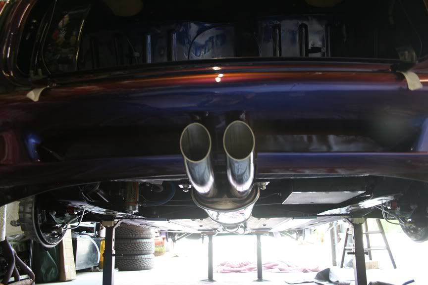

PostPosted: Sun Jun 10, 2012 9:22 pm
Posts: 460
Location: Goulburn NSW
Like this.

Here is my centre mount RC40.

I can't see the mounting points. :roll:
PostPosted: Wed Jun 13, 2012 7:13 am
Joined: Tue Nov 16, 2004 3:37 pm
Posts: 218
Location: Phillip Island VIC
Can you read? michaelb gave a pretty detailed description of them above. That along with the photo pretty much says it all.
