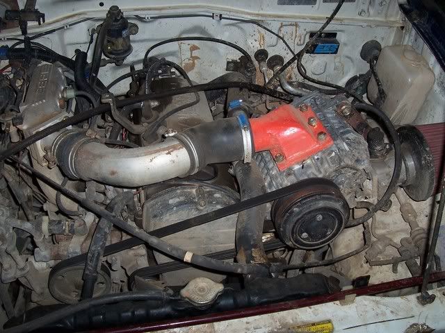

PostPosted: Fri Mar 09, 2012 9:49 pm
Isn't the SC clutch designed (or ment) to release the SC drive when the car is at idle.
On my old SC14 charged feroza we welded the clutch. It worked and ran fine but it created massive vacuum at idle, enough to suck the silicone hoses to near closed. We had to insert coiled stainless steel tig wire inside the pipes to prevent them closing in on themselves.
If you don't have any flexible piping it won't matter.
In this 1st pic the pipes were short enough not to suck in too much;
Once we added the intercooler with the longer pipes, that's when we had the collapsing problem;
