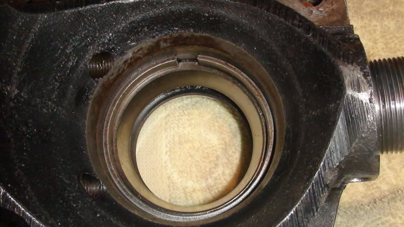

I am reassembling my Cooper S disk hubs.
I have always had trouble with grease getting on to my rotors only on the right hand side.
I noticed tonight that the left hand hub has an extra ring which sits above the bearing cup then the seal sits onto it.
Could this be the cause of my problem
also how much grease do you need to put in the bearing.
I will try and find my spare camera to take a pic
just another thought is there a plastic shield that goes on the cv
Ta
Kiwiinwgtn

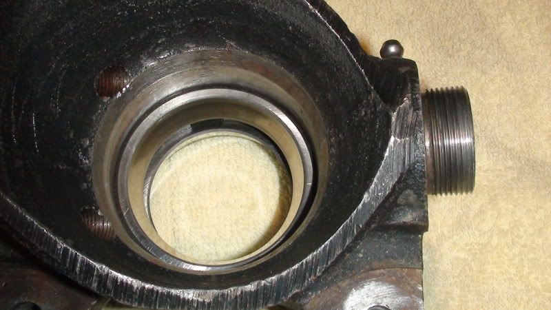

there appears to be an additional ring in one of the hubs

Yes the ring is to space the inner seal correctly onto the CV. I have had some of the 'new' tapered bearing kits that have a small plastic spacer thing that goes on the inner side that does the same thing.

looks like part 21a1307 is what i am after

I thought that plastic ring went on the outside of the seal.... there was a lip on the inner (CV side) seal that it fitted over. Unless we're talking about something different. Never mind :)
That split ring should be there, but it's not essential. I assume most of them got thrown away by ham fisted mechanics who discovered them after putting a customers car back together and had left them out by accident.
All I used to do (before I bought my current car that does have them still) was make sure the inner seal was only in as far as the machined part of the upright - IE only in as far as it needed to go.

The split steel spacer ring is a good idea if you have one, otherwise you can knock that seal in so far that it fouls on the inner journal of the tapered roller bearing (doesn't happen with ball bearings).
From memory, the disc brake/tapered roller hub ones are .205" wide (the drum brake/ball bearing ones are much narrower).

ok, I think the seal could have been in too far and I may have been a tad generous with the grease.

ok i have found a metal ring.
I have also got the plastic type now are unsure which one to use as the plastic one is about twice the width of the steel one
how can I tell which one to use, it appears to be dependent on the type of bearing
Thoughts..
