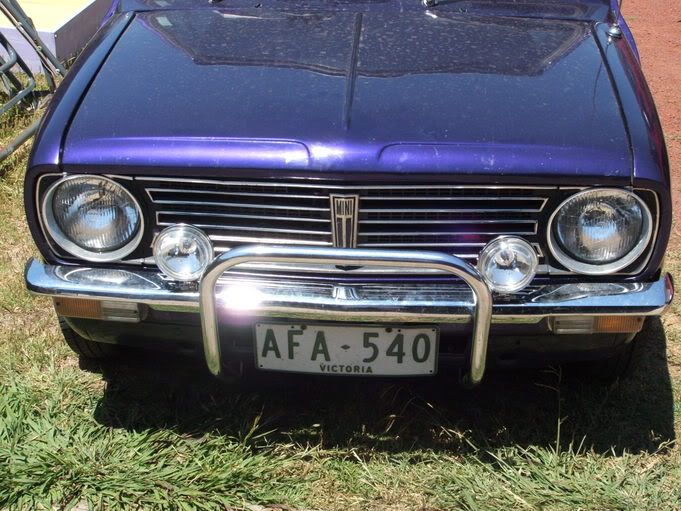

PostPosted: Mon Jul 23, 2012 8:52 pm
Posts: 2027
I drilled holes in the bumper bar and attached them. Here's a pic
Rod Image

PostPosted: Tue Jul 24, 2012 5:51 pm
Posts: 2027
Still dead easy to get the grill off :)
Rod Image
